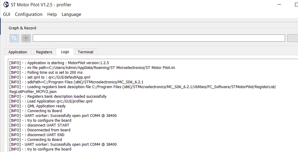

Can't connect Motor Profiler using IHM03 Kit using SDK6.2.1 or SDK6.2.0
I received the IHM03 Motor Kit, which spins the supplied motor "out of the box", but I can't connect through the UART port and run the Motor Profiler. The Profiler attempts to connect at different baud rates then fails with an error that it can not connect. I can connect to the board using the STM32CubeProgrammer with no issues.
I've seen several posts on this issue but no resolution. I can't run the Motor Profiler / Pilot ....

    Hello @BTrem.1 ,
    Did you flash your board with a binary compiled from a project generated with the MC Workbench 6.2.1?
    Best Regards
