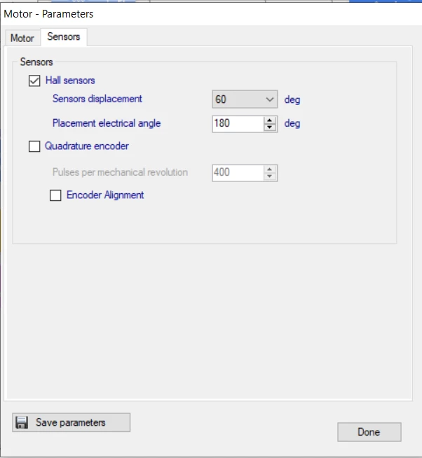

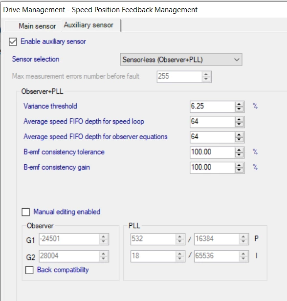

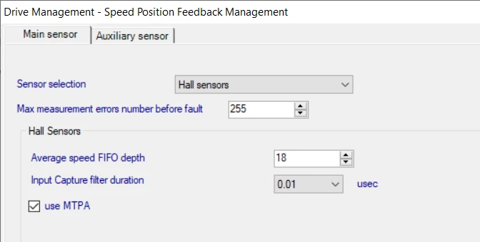

My customized IPMSM BLDC motor have 10 pole and 12 stator slot, operating voltage 36V and nominal current 8A, hall sensors with 60 degree placement. I use the STM32G431R8T6 microcontroller for FOC operation and hardware is customized. I use the ST motor control workbench 5.Y.4 version.
I able to run the motor with sensorless method and also able to increase/decrease the speed and torque.
But, unable to run the motor with hall sensor based. I give the placement electrical angle is 180 degree based on the below calculation.
360 * pole = mechanical angle,
360 * 10 = 36 degree (mechanical angle),
electrical angle = (pole/2) * mechanical angle,
electrical angle = (10/2) * 36,
electrical angle = 180 degree.

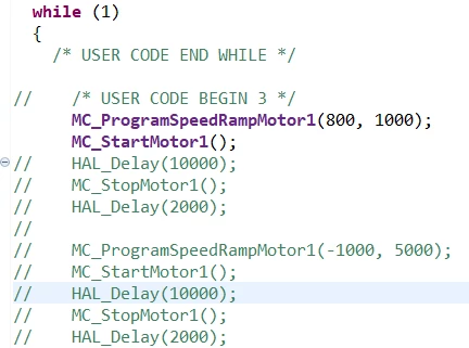

By applying the above electrical angle parameters to ST MC WB and generate the code. Then flash the firmware. Initially the rotor oscillated, and I turns the rotor manually for few steps. The rotor tried to start rotating, but after 72 degree (2 steps) the rotor was stop.

 Hello prasanthkumar170723,
I think there may be an error in your Placement electrical angle. It's determination is well described in MCSDK 6.1.2 documentation (Launch Workbench 6.1.2 -> About -> Documentations -> User Manual -> Hall sensor feedback processing)
