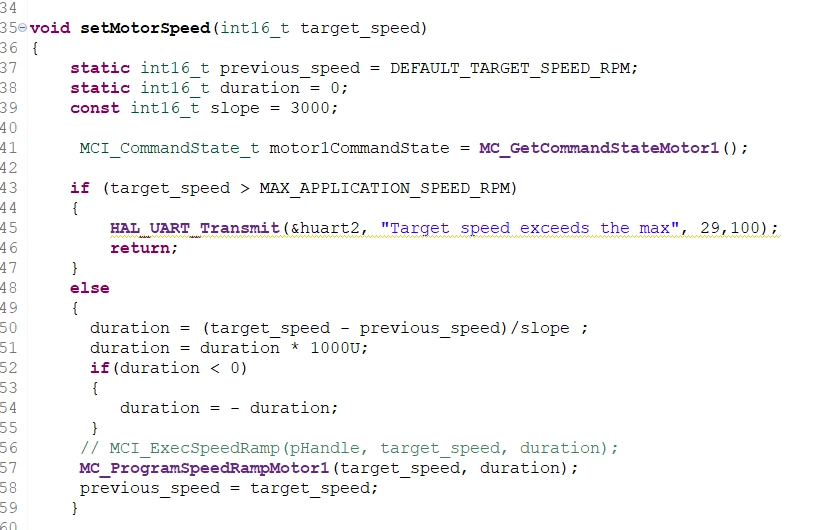

    void MC_ProgramSpeedRampMotor1(int16_t hFinalSpeed, uint16_t hDurationms)
    The ramp is with respect to the time that is you may want to achieve the speed in 5seconds, 10 seconds etc. To change the speed you have to update the  hFinalSpeed, provide different values as arguments to the function MC_ProgramSpeedRampMotor1 for example 100, 200 RPM (verify the units the function MC_ProgramSpeedRampMotor1 expects). Can you show how you are passing parameters to  the MC_ProgramSpeedRampMotor1 function?
    SRedd.5
    Senior III
    December 14, 2023

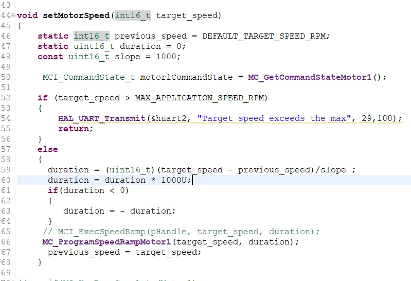

    I find mistakes duration is unsigned but you are checking for less than 0
    The targetspeed is a signed value but you are passing unsigned value. Please check those coding errors.
    December 15, 2023
    I have changed to signed but still the ramp is not reflecting in the motor

    You are checking the duration < 0, but that will never be True.

    This is the code i am using to generate the ramp in six step algorithm, The MC_ProgramSpeedRampMotor1 api is created in six steps to modify the ramp; however, ramp changes cannot be made with this api.  Could you please assist me? Is there another method to modify the ramp in a six-step algorithm?

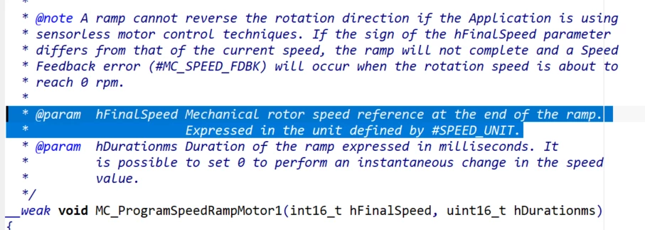

    ADAVE.1
    December 19, 2023
    Are you sure that the effect of your code is not an overcurrent event?
    I see an error in the usage of the speed. As indicated in the documentation the api accepts the speed expressed in #SPEED_UNIT.
    So, I suggest to use the macro RPM_2_SPEED_UNIT(rpm) to convert it before calling the function.
    MC_ProgramSpeedRampMotor1(RPM_2_SPEED_UNIT(target_speed), duration);
