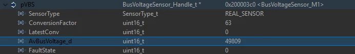

I would like to know when the VBUS voltage measurement is updated. I am using the functions to read the voltage:
VBS_GetBusVoltage_d
VBS_GetAvBusVoltage_V
I am using the threads startMediumFrequencyTask, StartSafetyTask, and my own thread.
At system startup, I want to load a buffer. But the measurements taken are incorrect or zero at the board startup.
Is there any documentation on the acquisitions?
MCSDK : 6.4.1
Best regards.

The raw VBUS value is obtained at the medium-frequency task in mc_tasks.c:
 uint16_t rawValueM1 = RCM_GetRegularConv(&VbusRegConv_M1);
 CodeReturn |= errMask[bMotor] & RVBS_CalcAvVbus(&BusVoltageSensor_M1, rawValueM1);
The latest conversion is then available in VbusRegConv_M1.data.

Might be a bug in the library...
I do see the variable AvBusVoltage_d increasing over time, but LatestConv always stays at 0.

Hello GMA,
Thanks for this answer, it's all good.
