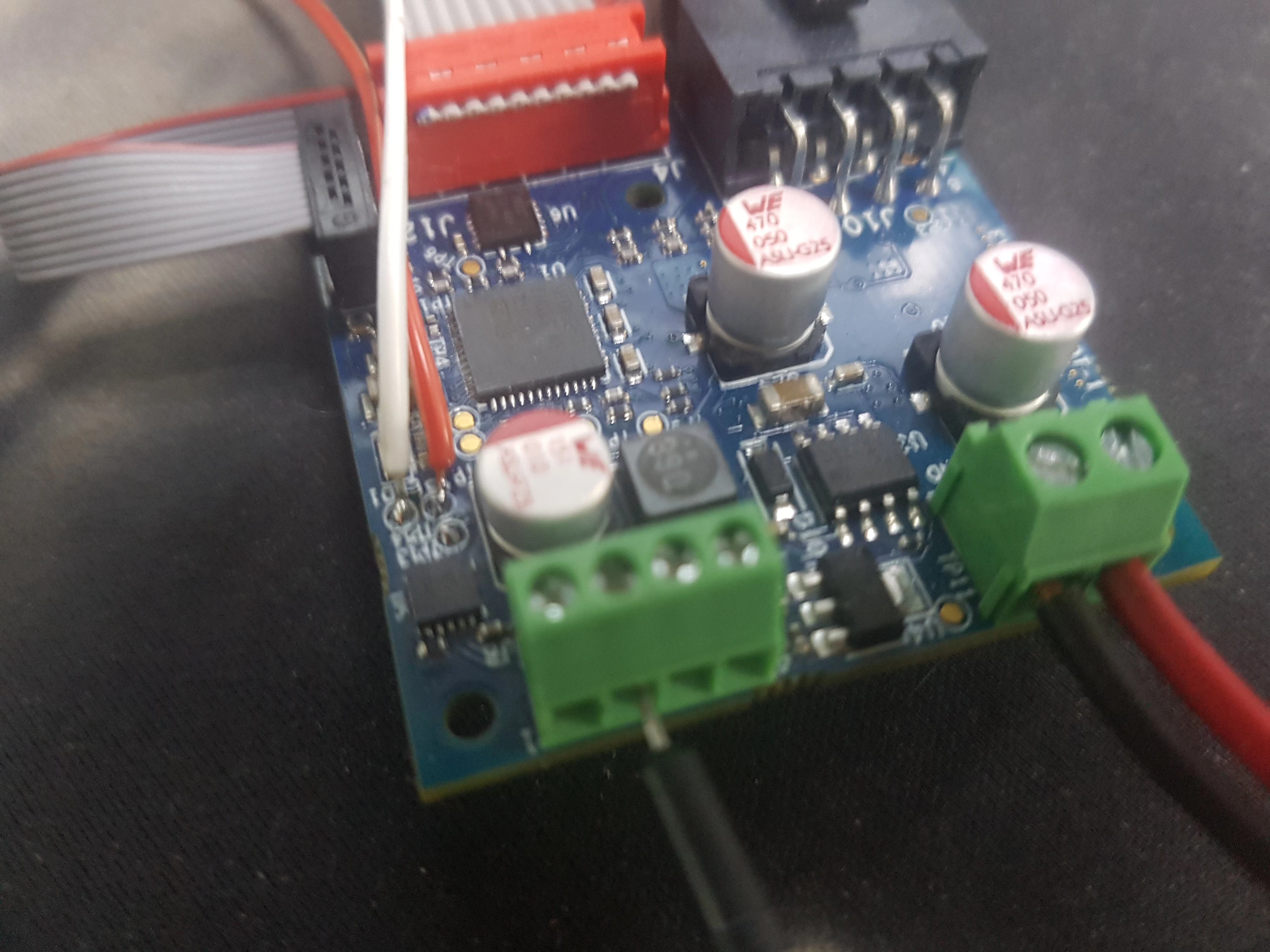

to get reliable (and unaffected) timings and behaviour of the f031, i simply connected step/dir signals to PA15 / PB6 via the provided TP´s. For debugging, i just use the step signals, directly evaluated in TIM2 (external trigger) counter. All the modbus / usart stuff, according timers / interrupts are just disabled. This gives me a "testing environment", where i can be (more or less) sure, if something is wrong, it comes from the mcsdk ;) I attached a picture of the soldering and an "early" video, where partly the dir signal is still active to give you an impression, how it works. 0693W000000X9CbQAK.jpg
I haven´t had much time this weekend, to further investigate, what´s going on below the surface, bat as far, as i remember, in trajectory and in pid controller is a lot of "weird" stuff. Example: TC_FollowCommand, that "ReceivedTH" member of the pHandle struct: In my eyes simply useless... In follow mode, the functions shall be called repeatedly (in main loop ?). So after two loops, it reches the max. possible value of 2 and therefore the "if (pHandle->ReceivedTH > ***)" statement is definitely useless after two loops. Even at 1st call, it´s not necessary and could save some valuable flash space (and maybe one or two cpu cycles xD).

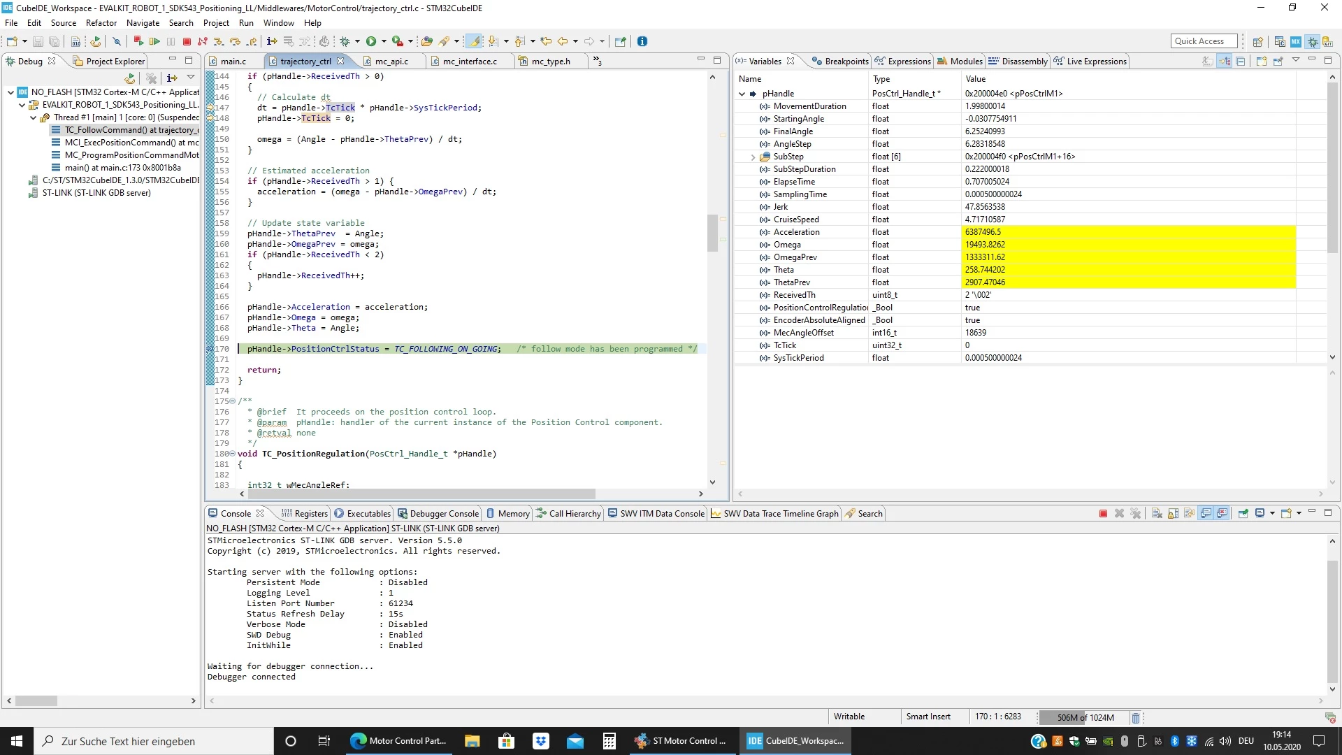

May 11, 2020 6:44 PM UTC
Hello @claire OKU​ , hello @Community member​ 
I´ll try to do my best xD Ok, 1st the promised screenshot, while debugging and searching...
As you can see, it stopped at breakpoint in line 170 of trajectory_ctrl.c. In lines 160 and 167, the struct members Omega and OmegaPrev are equally set to the value of the previous calculated (and never altered afterwards) omega variable and therefore should be equal. Also Theta and ThetaPrev in lines 159 and 168 ... Theroretically set to the given function parameter "Angle", which also isn´t altered inside the function. Of course the calculation of "omega" and "acceleration" in lines 150 and 155 rely on ThetaPrev and OmegaPrev ...
Problem here: As far, as i understand the reading of the pHandle struct at the moment, the program stopped, something definitely has happened to the members, while execution.
Correct me, if i´m wrong, but my 1st thoughts went to some other functions, which are able to alter these values, when they are called within an interrupt somewhere between setting them originally and the stop at the breakpoint. It´s very suspicious, that this doesn´t happen all the time. It needs some luck to "catch" that.
At the moment, i took the screenshot, all the original files have been on their original state (exept a) main.c, where i set the target angle and call MC_ProgramPositionCommandMotor1 for the movement and HAL_Delay(1) afterwards , b) the three altered files from the original bugreport) The routines in main are:

wDeltaError = wProcessVarError - pHandle->wPrevProcessVarError;
 wDifferential_Term = pHandle->hKdGain * wDeltaError;
 wDifferential_Term >>= pHandle->hKdDivisorPOW2;
 pHandle->wPrevProcessVarError = wProcessVarError;
 wTemp_output = PI_Controller( pHandle, wProcessVarError ) + wDifferential_Term;
Hmmmm..... Ok ....... Not really, what i would expect from a differential calculation ;)
Ok, digging around more and more (and very late at sunday night...) i gave up at some point...
My last try was:
Ok, TC_PositionRegulation is called indirectly from sysTick isr...
So without changing the target angle, it works.
If i try to move the motor by hand, it regulates back to the position, where it should be.
everything needed for that is:  hTorqueRef_Pos = PID_Controller(pHandle->PIDPosRegulator, wError);, where wError is derived from pHandle->Theta and applying that...
So why not just updating pHandle->Theta without any further calculations or "workarounds" and let´s do the PID (more or less) it´s job....
What shall i say: This works, as intended, but anyway: The PID results still lead to the same problem: A BEMF spike, when it should decelerate and therefore a shutdown of the motor 
I´m really sorry, that i´m not so experienced in that... And also english isn´t my 1st language (i´m german...). I have just seen: Something definitely goes wrong here xD For example: Just debug pid_controller.c, move around with the motor a bit and watch pHandle->wProcessVarError... Even with a given input error of near 0 it stays at very high values and just get´s balanced by wPrevProcessVarError ;) So also try Kd at zero... You´ll experience some surprises ;)
Edit: Nearly forgotten: These "if (pHandle->ReceivedTh > ***)"-statements in lines 144, 154 and then 161... After two calls of the function, they are senseless... And also not necessary at all ;) For "ReceivedTh", in the whole library, these are the only times, where it´s used. So i think the whole thing could be deleted...

Hi @Community member​
No problem :) In one of my posts from above (the one with the picture of the robot-1 board and the soldered cables) i attached a video. In this vid you can see my basic setup. Basically it´s a F746 Disco, sending step/dir signals. On the screen, you can see the sent "position", where every digit represents one step pulse (just to give you an idea of the frequency). At side of the robot-board, i just set up Tim2, connected to PA15 and receive these pulses into TIM2->CNT. In the setStepDirPosition-function from above, i check the counter value (every loop), check for overflows (counter is set up with ARR of 0xFFFF) and pass that to the "stepPosition"-variable without further editing. So it represents the "Absolute" position, received by step signals. On PB6 i connected the dir signal, which just triggers an interrupt at rising and falling edge. In isr i just change the counter direction of TIM2.
I already checked the "Receiver" behaviour in debugger and this works like a charm :) stepPosition variable always represents the same value like the "motorposition" from the f746 screen :)

I broke it down a bit further... Maybe this explains my thoughts better:
void TC_FollowCommand(PosCtrl_Handle_t *pHandle, float Angle)
 float omega = 0;
 if (pHandle->TcTick > 0) //to prevent division by zero
 omega = (Angle - pHandle->ThetaPrev) / pHandle->TcTick;
 pHandle->TcTick = 0;
else
 omega= (Angle - pHandle->ThetaPrev);
 pHandle->ThetaPrev = Angle;
 // pHandle->Theta = Angle; //further handled in TC_FollowExecution
 pHandle->Omega = omega;
 pHandle->PositionCtrlStatus = TC_FOLLOWING_ON_GOING; /* follow mode has been programmed */
 return;
void TC_FollowExecution(PosCtrl_Handle_t *pHandle)
 pHandle->Theta += pHandle->Omega;
 Edit: of course this is missing the final check, if target angle is reached.... Simplyfied that could look like Command: ReceivedTh = Angle and in Execution: if ((Theta-ReceivedTh) < Omega) ...

if (dt > 0) {
        omega = (Angle - pHandle->ThetaPrev) / dt;
if (dt > 0) {
       acceleration = (omega - pHandle->OmegaPrev) / dt;
Because the defualt value of omega and acceleration are both zero. Maybe is also the case to reset the ReceivedTh to zero because the expected sequence of estimation is not occurred.
Ciao
Gigi
chaaalyy
chaaalyyAuthor
Senior II
May 13, 2020 4:06 PM UTC
Now i understand the intention behind that :)
Then i have to say, these estimations are a masterpiece :) That´s, why i got some (just in my eyes) "strange" behaviour:
I tried the following scenario: (everything with moveDuration zero, so -> Follow Mode). I added 360 degree as target angle and delayed for 5 seconds (HAL_Delay(5000)). !st movement: one full rev. and stop 2nd time one full rev and continuing to turn slowly. 3rd movement: completing the already running revolution and continuing nearly seamless to turn smoothly :)
So it estimated correctly, the next "order" will be the same and moved in advance of my commands. It has been my mistake to assume the followMode is enabling the possibility to send different positions / movements at given intervals. This couldn´t work because a different command immediately will collide with the previous values. This also explains why PID has to work completely different than assumed and expected. I´m used to having the D-Part as … let´s say "lookahead". Of course this can´t work, when trajectory already had to do that. Thanks a lot for these informations :)
Gigi
May 14, 2020 7:26 AM UTC
​Thanks to you, I'm happy to see that my explanation has  been useful.
If you get other problems don't hesitate to contact us.
Ciao
Gigi
