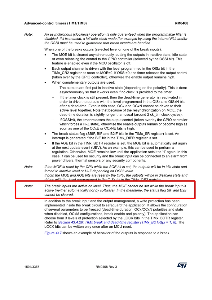

I have some problem using the Break interrupts (BK1 and BK2). When activated it keeps firing the break interrupt handler: TIM1_BRK_IRQHandler
We have measured the BK1 and BK2 signals and the states are as they scould be when activayted/deactivated and there are no noise on the lines.

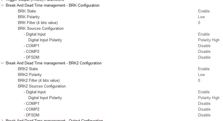

The BK1 and BK2 is setup in the Timer1 with correct polarity etc.
The PWM's are stopped when activated, but the interrupts handler keeps getting called!
Did I miss something in the handler?

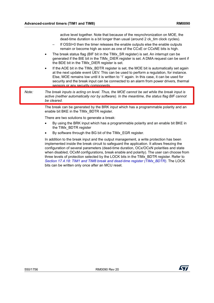

waclawek.jan
March 14, 2024
Essentially the same note applies:
So the question is, is the break source persistent? If yes, disable break interrupt in TIMx_DIER and reenable it only after the break source has been cleared.
