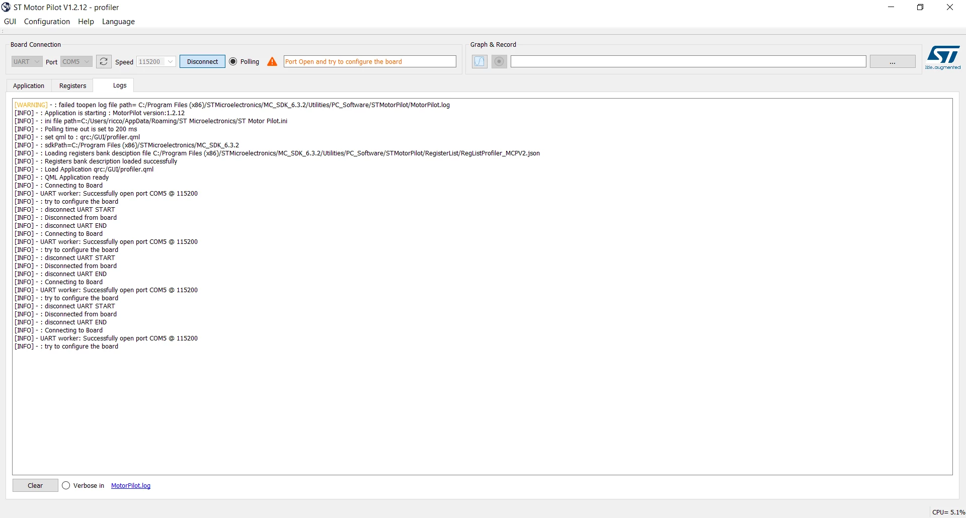

Unfortunately, I faced an error of "Port Open and try to configure the board and I'm stuck here. It's a very similar problem with this discussion :

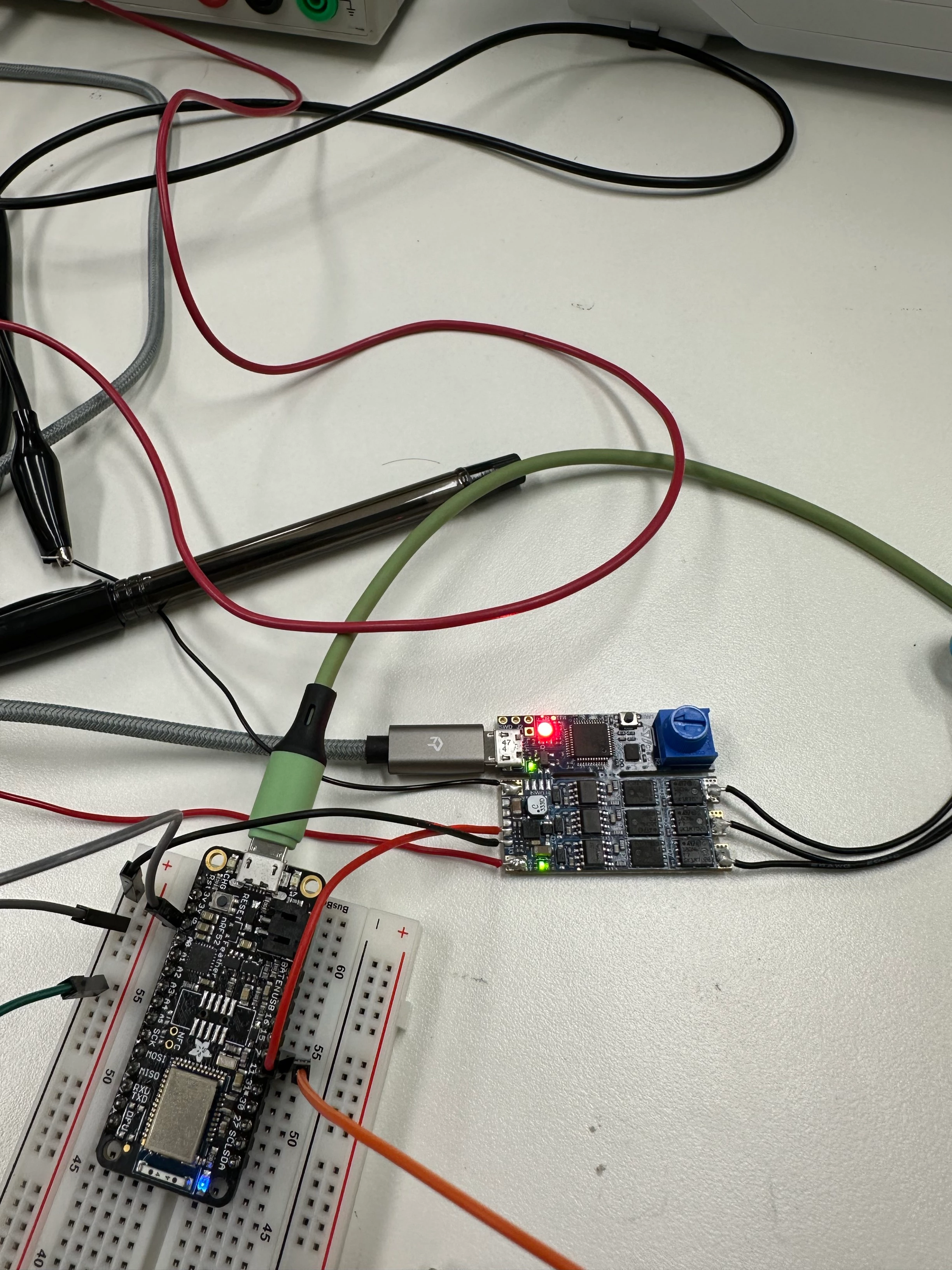

-. Please find my wiring on the photo attached.
-. So I have already connected the V+ and V- (3S Voltage - I'm interested in) to a power supply and also the PWM and GND to an external microcontroller (an Arduino setup generating 490Hz PWM).
-. Micro USB connected to my PC, also have updated the FW on STLINK Utility.
-. Flash the B-G431B-ESC1 firmware through the STM32CubeProgrammer.
-. PORT can be successfully opened with 115200 baud rate
I'm assuming the ESC is as easy as setting them up like that and Motor Pilot will just start profiling my motor, but am I still missing something of configuring the board?

By default, on Motor Pilot 6.3.2, used baudrate is 1843200.
If you agree with the answer, please accept it by clicking on 'Best answer'.Best regards.GMA

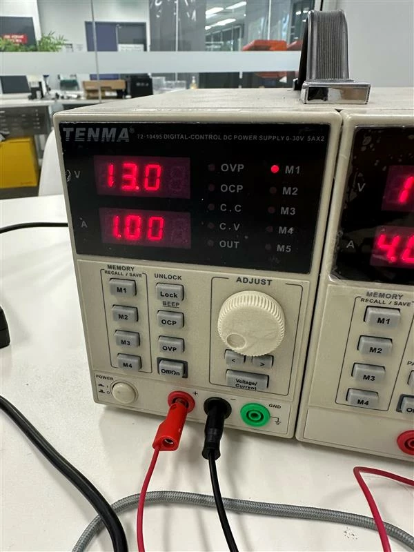

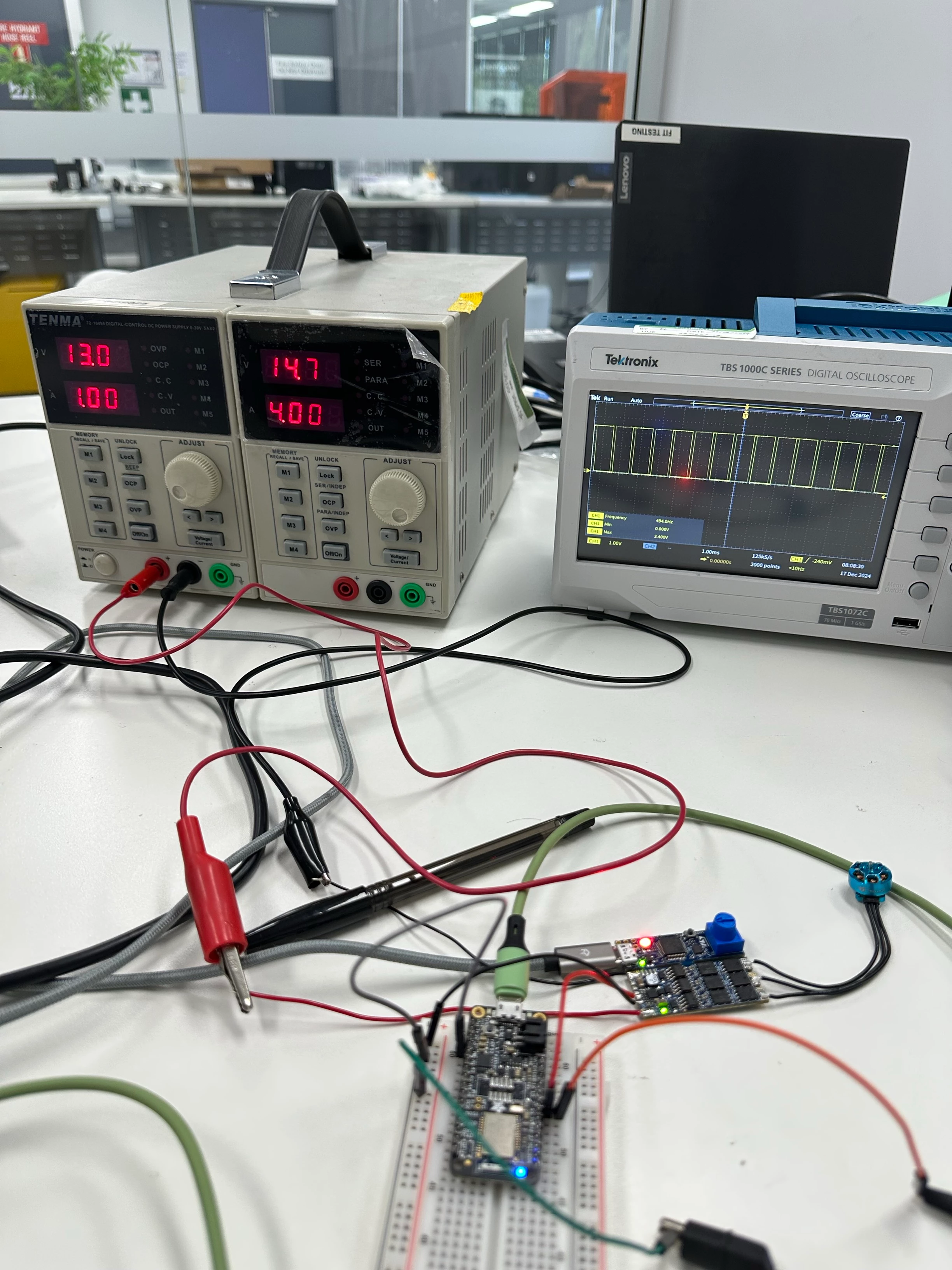

I still face the same issue even after changing the baud rate, setup at +13V. I attached images of my setup. Could you tell what's wrong with it? I think I'm doing minimum setup just to get it working..Image (9).jpgImage (8).jpgImage (7).jpg

It seems that you have 2 boards connected to your PC, did you choose the correct Port COM on Motor Pilot?
Sound strange that in idle B-G431B-ESC1 consumption is equal to 1A, idle current should be 0.03A...
Once B-G431B-ESC1 firmware flashed through the STM32CubeProgrammer, did you push the reset button?
At this point, did you try, after disconnecting the other board, to launch Potor Pilot V1.2.12 and click on "Discover Board"?
