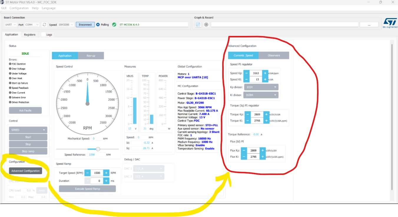

(2) Once I start to control the motor using motor pilot tool, I reach to this page as shown below:
I only tested my motor with default auto calculated PID settings, and with speed adjustment the motor rotated at the set speed although not very constant. I don't really know to fine tune these settings to achieve proper PID speed control for the motor. Could you explain to me more about this?

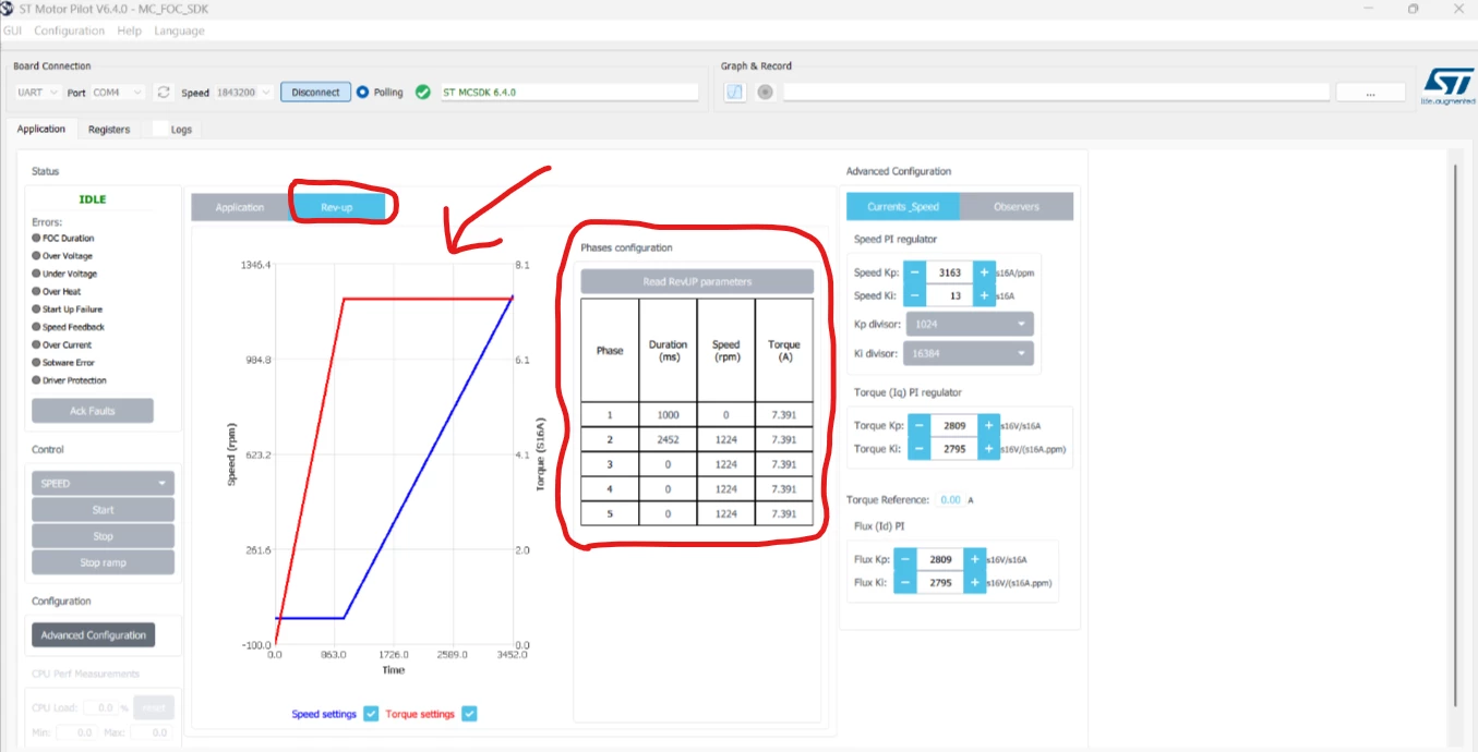

(3) Also, the motor was configured automatically with some rev-up parameters as can be seen below.
Do we need to make any changes to this set of parameters for our motor, and if so, what each step means and how to determine proper values for these steps?

(2) PID tuning is widely described in the literature. You can have a look to this training video.
(3) The RevUp period ensures a correct handover to the STO-PLL sensorless observer algorithm.

But would you tell me more of point (3) regarding RevUp period? Default is usually optimal, or should I change?
GMA
Aug 5, 2025 8:50 AM UTC
Hello @Neng,
RevUp period should be optimal.
