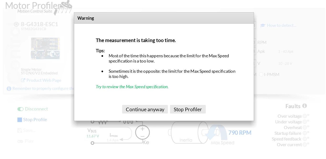

MotorProfiler 5.4.8: Measurement of Profile is taking too long, no matter how I change the values.

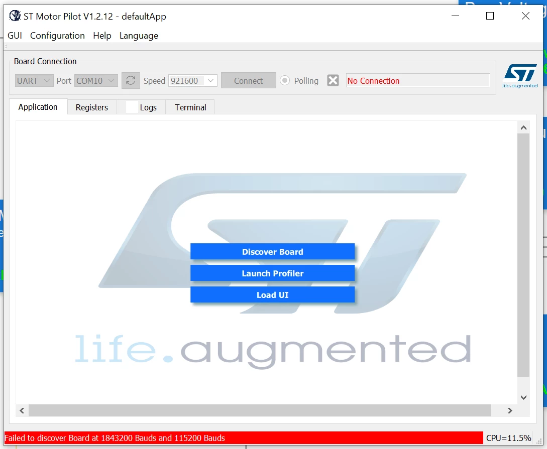

MotorProfiler 6.3.2: Can't connect to the Board. It can't even open the port. Does anyone know what the correct BAUD Rate should be?

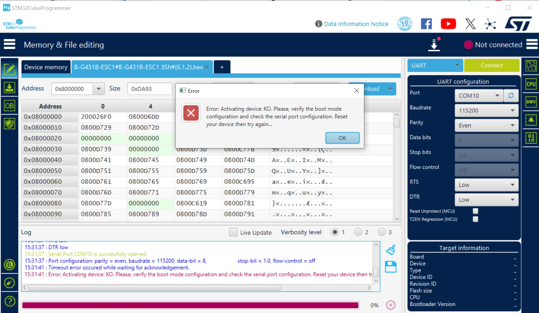

- Flash the file: ...\Utilities\PC_Software\STMotorPilot\STM32CubeProgrammer\Fw with CubeProgrammer, doesn't help, it still doesn't recognize the board.
Also opening the board in CubeProgrammer with the UART Connection is not possible, only the ST-Link works

Hello @orka375,
Generating B-G431 with MC-SDK workbench 6.3.2, used Baudrate is available on the "user Interface" tab.
Using the "Discover Board" button on MC Pilot V1.2.12 should work.
If you agree with the answer, please accept it by clicking on 'Best answer'.Best regards.GMA
