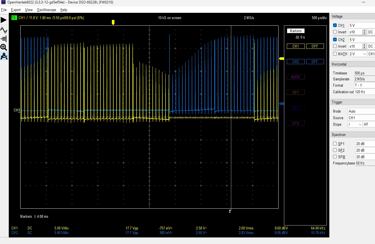

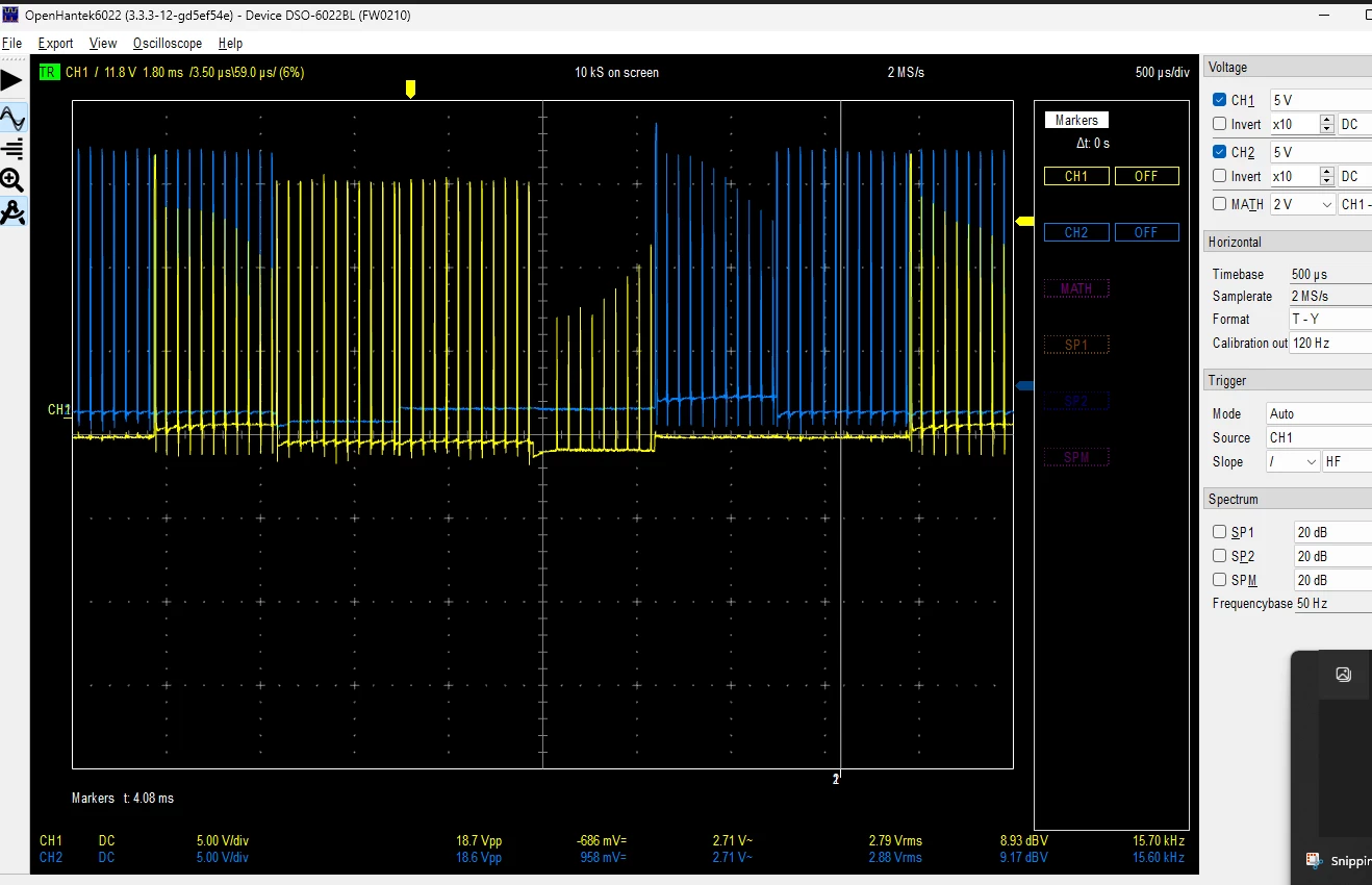

Hello, I'm trying to use my B-G431B-ESC with the 6-step algorithm. I''ve tried with a coupld of profiled motors and what happes is that it starts up fine, but after ~2K RPM, the motor starts to squeel and lose power. I feel like this has something to do with the back EMF sensing... Has anyone got the B-G431B-ESC working in 6-step? Are there any tips for tuning the BEMF parameters?
Thanks
BTW, I've tried playing with all the BEMF parameters, and other things like the modulation frequency and other parameters but it still starts to break down above 2kRPM (increasing the modulation frequency helps a little bit, but not nearly enough).

Working, right before 2KRPM
Squeeling starts, right around 2KRPM:

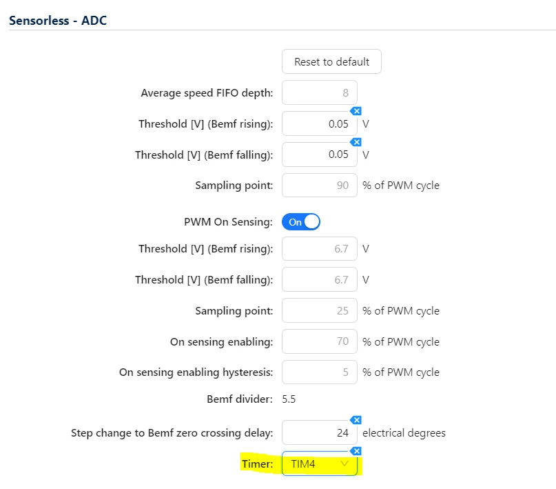

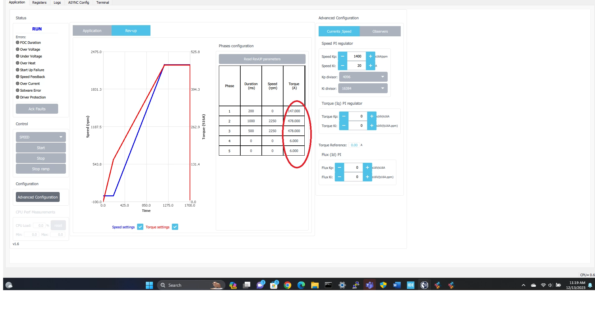

    Glad to hear that you managed to get through it.
    1. That's in fact a feature (open loop mode) currently missing but that will become available soon in the next release
    2. I see you are using a wrong interface (the FOC one). You can load the 6step interface of the MotorPilot by clicking "GUI" in the upper bar, then "Load GUI". You have to select the "MC_6STEP_SDK.qml" file in the installation folder (that in my case was "C:\Program Files (x86)\STMicroelectronics\MC_SDK_6.2.0\Utilities\PC_Software\STMotorPilot\GUI"). You can get all the updated documentation on the web page Web page documentation or in Motor Control wiki wiki_Motor_Control
    3. To avoid the conflict between MCU resources, select a different timer for the speed controller in the workbench (tab "Speed sensing config", for instance TIM4)

    - What are the BEMF thresholds and demagnetization period that you set?
    - In the image, the yellow curve looks weird: the baseline is negative. Is it an acquisition issue?
    - Did you try to reduce at minimum the PID gains to exclude a speed controller issue and run the motor in pseudo open-loop mode?
    You can also have a look at the UM3259 for troubleshooting UM3259 - 6-step firmware sensor-less parameter optimization
    Despite the issue at 2krpm, If I'm not mistaken, the motor is running at 16kHz. Consider that with 7 pole pairs, it means around 10 pwm cycles for each step (10 bemf acquisitions or less if you consider the demagnetization time) at 2krpm and less than 2 cycles at 12krpm. It won't simply work at that frequency with 6step.
    I don't think so, I am using a working oscilloscope, and the signal looks perectly normal right before 2Khz, (the first image).
    I just know that the trapezoidal waveform looks much different immediately when the problem threshold RPM (~2K) is hit. I've never seen anything like this on other platforms I've implemented 6-step BLDC commutation on

    I tried to replicate your set-up with the G431-ESC. I used a BullRunning BR2804 motor (the one pre-defined in the workbench) that looked similar to yours (rated voltage 12V, 7pole pairs, high rated speed, low voltage constant)
    1. At first I ran it at 16kHz. Improving the speed loop gain, reducing the bemf thresholds and the demagnetization time at the beginning of each step ("minimum demag time" in the "Drive settings" section), I easily reached 4.5krpm. Beyond this speed, the motor starts to hiccup until overcurrent occurs. As said in my previous post, at this speed there are very few points to discriminate the bemf zero crossing (4-5 points, one each pwm cycle) and the desyncronization of the rotor is unavoidable
    2. Then I increased the frequency to 50kHz, reduced the 6step loop execution time (to limit the number of interrupts and the MCU load), tuned the startup parameters and the delay between the zero crossing and the step changed. I reached over 12krpm.
    I attached the screenshots and the wbmx6 files I used to generate the code, hoping that they are of any help.
    December 13, 2023
    Thanks, I was able to get the motor working at nearly desired RPM using the combination of things you mention.
    1. You metioned some kind of open loop mode where I'd be able to directly set
    2. The circled are in the picture above has strange values which I don't udnerstnad the meaning of. . Where can I get most up to date documentaiton on all of these parameters? (I find the format of the PID controller values very confusing)
    3. When I try to enable the ESC PWM control input, I get an error for re-allocation of TIM2 on the build. What is TIM2 used for in this app and can another timer be used instead (ESC PWM detection seems can only use TIM2, which makes sense since there's a hardware connection there)
