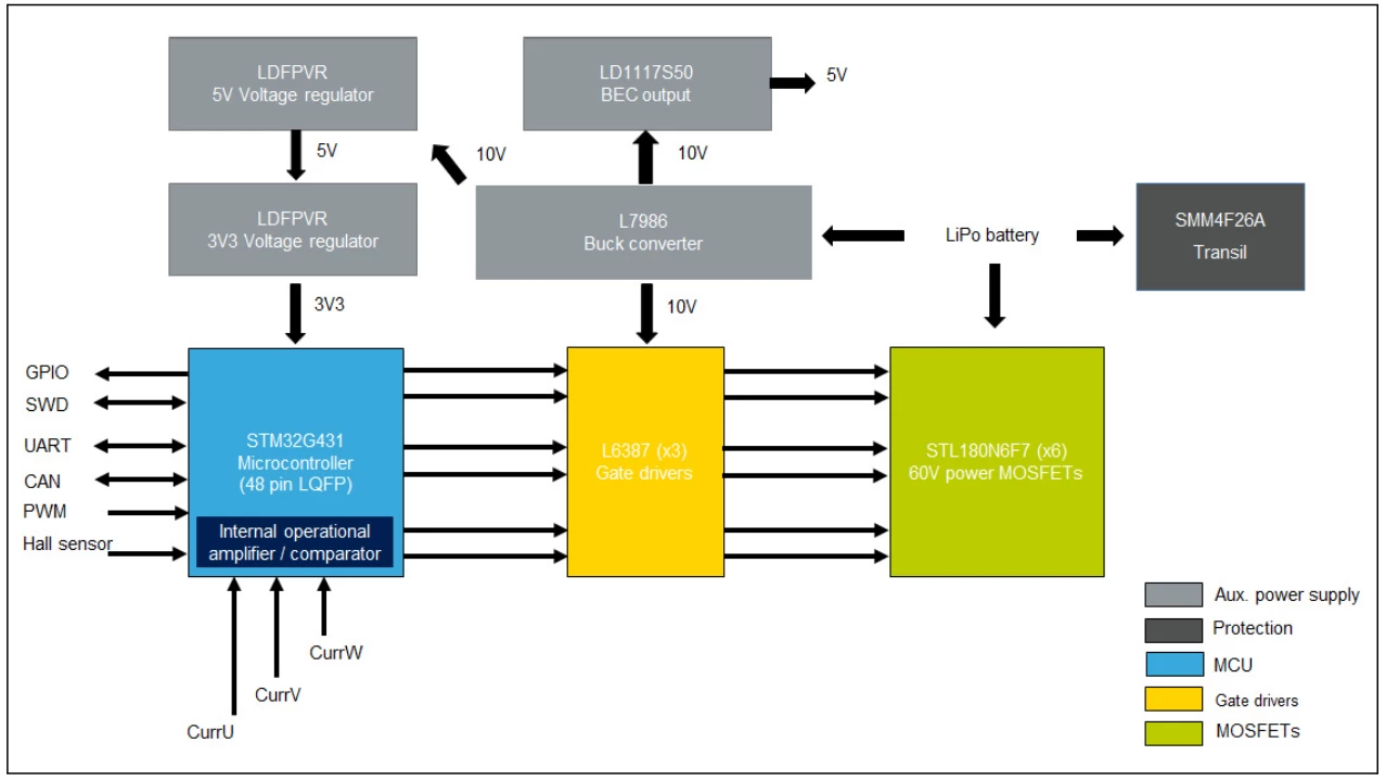

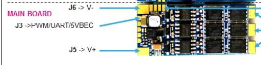

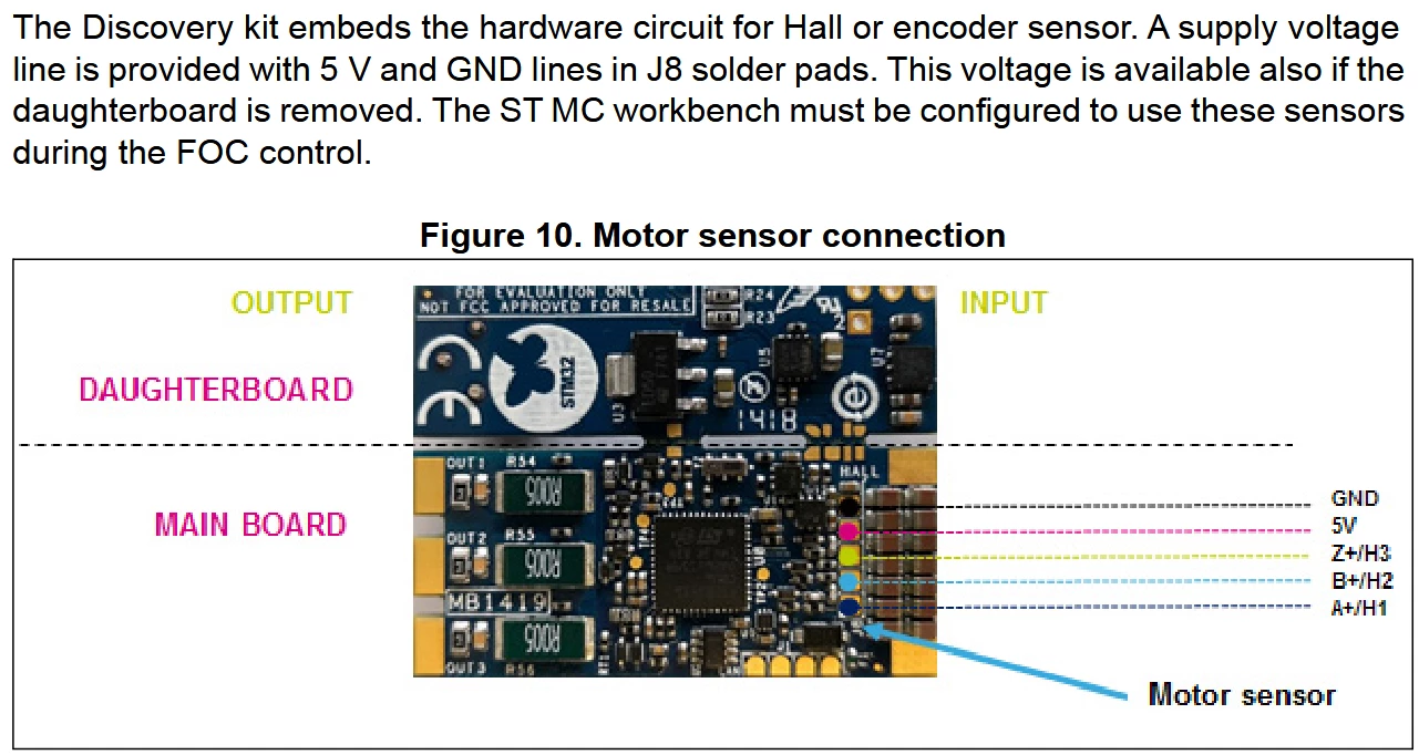

I am using B-G431-ESC to control a brushless motor. Using Arduino and simpleFOC, I am able to control the motor in open loop setup. When tried using hall sensors pins, i see that there is no voltage on 5v pin on the esc board. The multimeter shows no voltage across the 5v and Gnd pins.
The user manual says pinouts as H1, H2, H3, 5v and ground.
Attached the two images.
Do I need to use any jumpers for 5v, or enable and bits, or does it mean i have a faulty board?
Please suggest.

    What is the input voltage you are providing to the main board?
    Praveen Kumar_2
    December 26, 2023
    Input voltage to main board is 12v 3a lipo.
    SRedd.5
    Senior III
    December 26, 2023
    Do you have the schematics, did you check for continuity?
