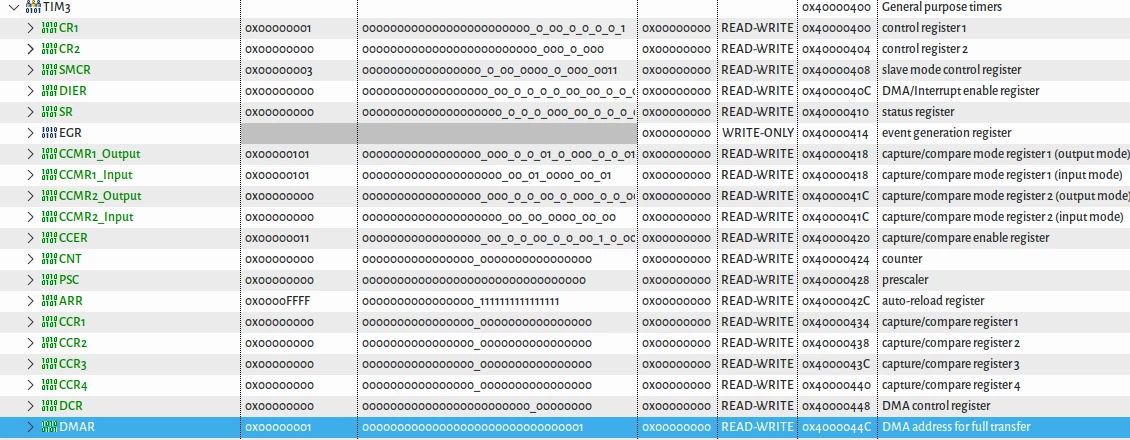

I'm trying to get an AMT102-V rotary encoder working together with the TIM3 on my STM32F407 MCU.
For some reason, the timer is not detecting the encoder pulses. The signal looks good on the oscilloscope, the only thing that I see, there is a bit of noise in the low output state of the encoder.
To verify my input pin works, manually pulled the index pin, connected with my EXT1 interrupt, to ground and it was correctly triggered.
Interestingly, when the encoder output is transitioning from high to low, the interrupt is not triggered.
On the electronics side, the only thing between the STM and the encoder is 120R resistor, which shouldn't make any problems.
Am I configuring the GPIOs correctly? What could be the problem?

Remove the code related to index. Still no work? Read out and check/post TIM and relevant GPIO registers content.

@Community member​ Thanks, removing the index code doesn't unfortunately.
Viewing at the registers, I noticed that the SR update bit was set, so I reset it before timer start. No difference. Here is the full register dump:

Looks good.
Now the relevant GPIO registers' content?

Wait.
PD2 and PD7? They don't connect to TIM3_CH1 and TIM3_CH2. See Alternate function mapping table in the datasheet.
ARöss.1
ARöss.1Author
June 30, 2020
@Community member​ Thanks, that was exactly the information I was looking (but not hoping) for. Reconnected to C6/7 and it works!
