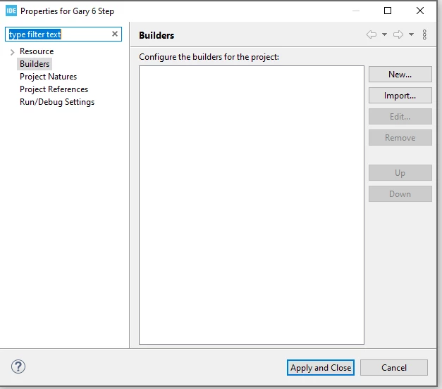

After an upgrade to IDE 1.11.0 on the windows platform, my project would no longer build. The project...Builders list was empty.
I had IDE 1.10.1 and a Nucleo-G431RB board. We created a 6 step project using motor control Workbench, Motor Pilot and the project would build successfully. The IDE updated to Windows 1.11.0 and the project would no longer build. The builders list was empty.
Reinstalling 1.11.1 had no effect. Recreating the project from motor control workbench had no effect (I didn't expect it to - I assume this an IDE config issue, but I wanted to try it).
I could not find a way to restore the builder list. I am new to this platform.Reinstalling the old version 1.10.1 after renaming the ST folder which was not empty has reinstated the builders list and I can build again. My project was present in the IDE without me having to import it, much to my surprise.

this:

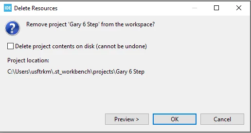

I went into CubeMX and made some changes, then clicked "Generate code"

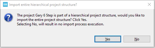

When this was complete, I selected "Open project" from the CubeMX generate code which opened the project in the IDE.

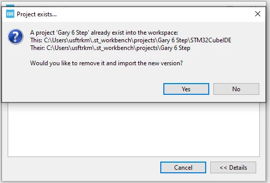

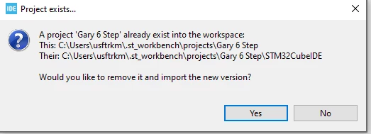

The IDE popped up I think 3 modal dialogs which I clicked through - I will try to reproduce these today, but I believe it was saying that the project was hierarchical and needed to be imported. I clicked on "Yes" for these dialogs, and now the builders list is empty again. See above.
I remember doing this before, on 1.11.0.
It is not an upgrade issue.

Last time I selected "delete". This time I did not.

Builders list as above - empty.
