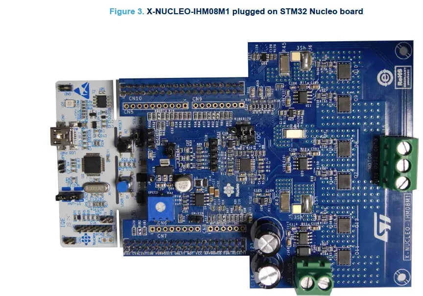

how did you connect to the H7 board ? (because its for morpho connector on nucleo64 boards fitted.)

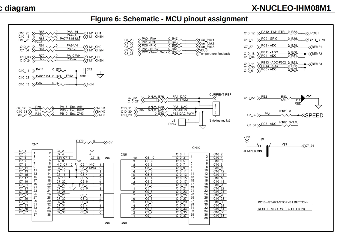

As for the used pins, I have bemf_A (PC3), bemf_B (PC4), bemf_C (PC5), and BusV (PA1). These are different to the pins you mentioned but I am relatively confident they are correct and have verified that the correct physical pin on the shield corresponds to an output.
If possible could you guys provide any insight into the issue I might be having with the current sensing ADCs (maybe they need to be configured a certain way?) or my brief comment above regarding how to manage voltages and currents being a positive or negative value, with respect to how I should be setting up the code and the variables used.
Thank you so much for your help! I really appreciate it
AScha.3
Nov 5, 2025 12:42 PM UTC
Just compare pin for pin position on the IHM08M1 to the connected pins on STM32H723Z-nucleo , then you KNOW:
PhA - PA3
PhB - PC2
PhC - PF10
BusV - PC0
+ verify this.

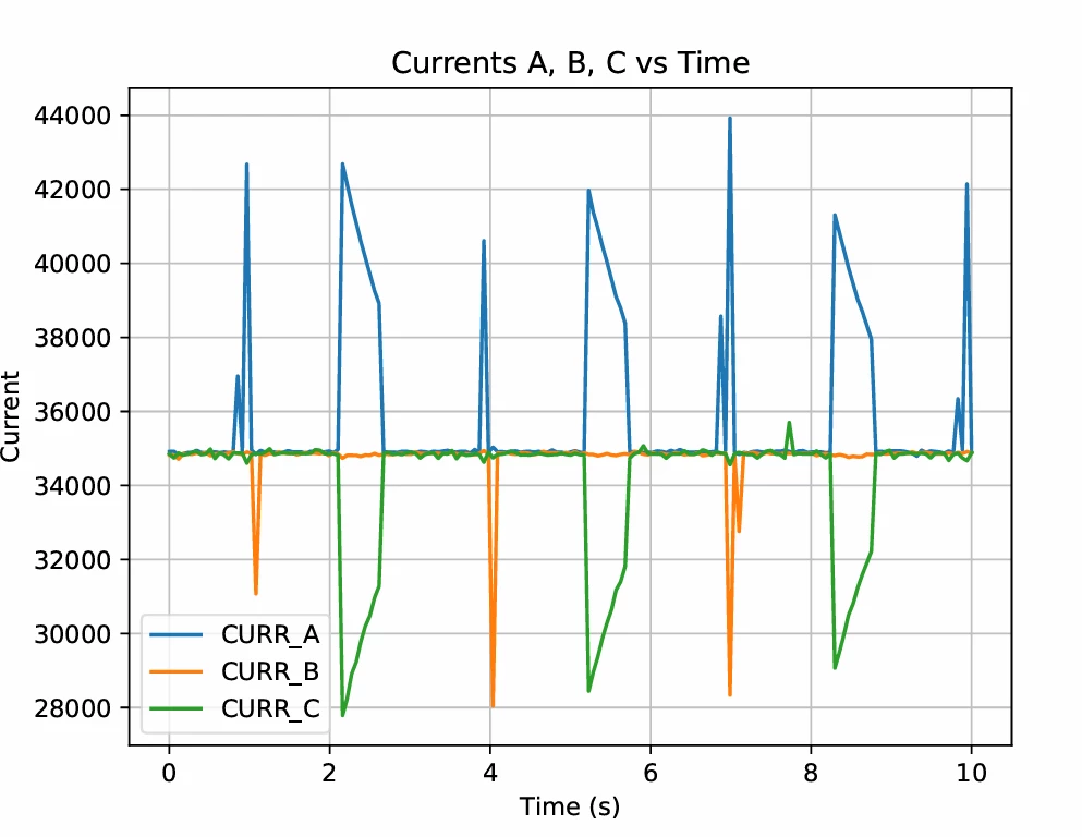

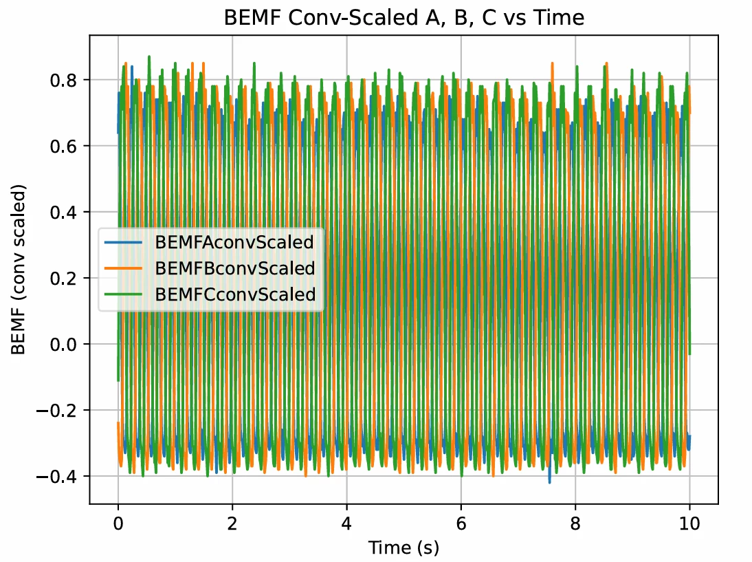

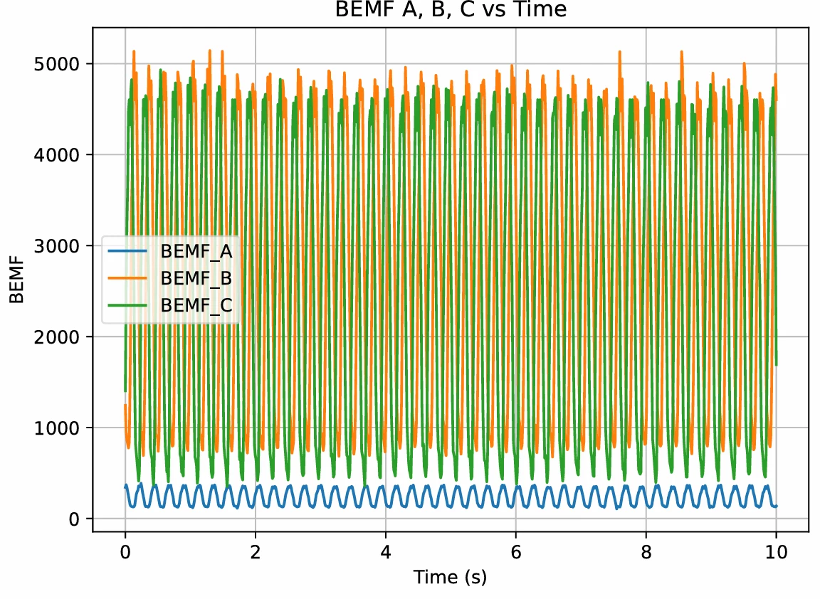

I've moved on from trying to configure adc3 with the bitshift. I've scaled them all differently and applied an offset value to line up 0 with the floating disconnected value. I'm not sure if this is the correct approach as you can see in the BEMF converted figure, what I believe is a phase-neutral measurement now has some negative value because of the offset, I'm not sure if this is acceptable or not.
@GMA mentioned validating the measurements with a scope. I noticed that when I spun the motor with a hand drill, the ADC pin would measure (with an oscilloscope) a 0.4V p-p reading whereas in software it would be ~1V, I'm not sure if my conversion is wrong, I am just doing a simple voltage divider calculation between R39 and R36.
Additionally, I had a question about converting the current sensing adcs, I was able to get the following data in the currents, A, B, C figure but am unsure of how to convert this into meaningful data.
