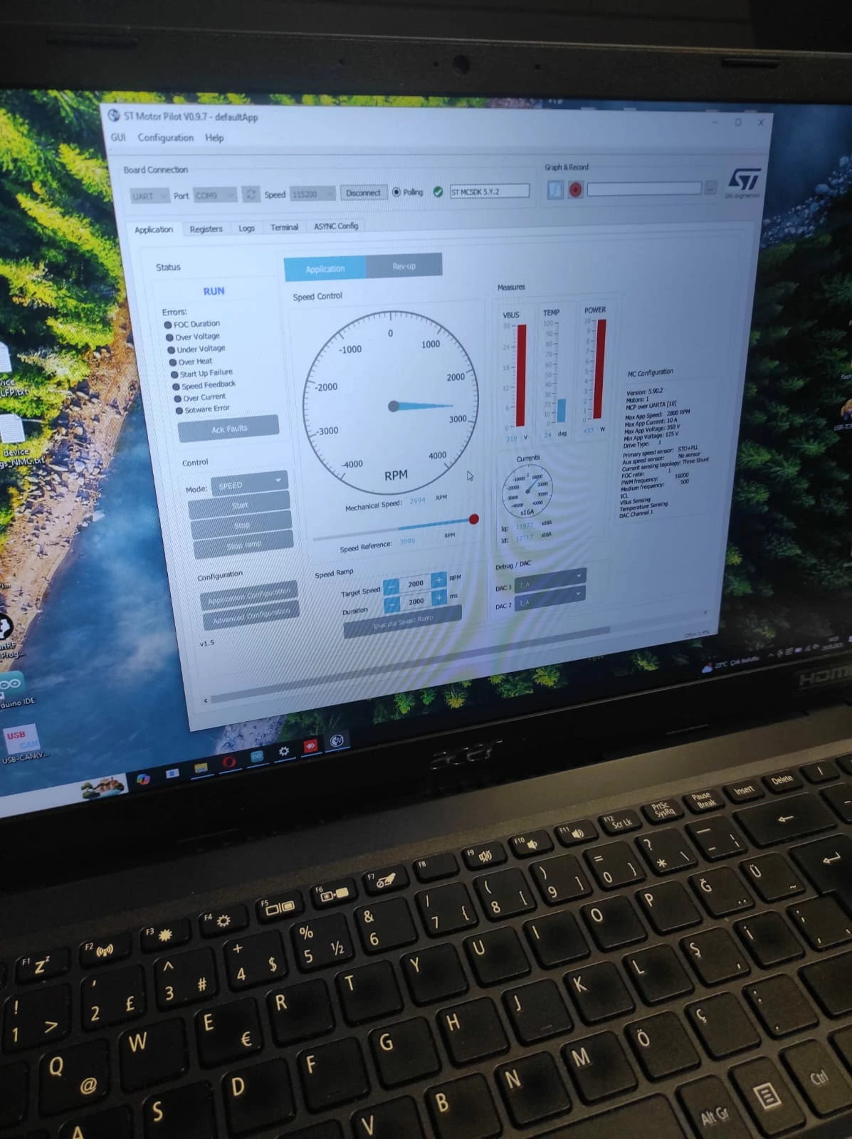

I can't increase the motor speed beyond a certain point.
For example, when using the ST Motor Pilot interface, I set the Speed Reference variable to 2500 RPM, and the Mechanical Speed reaches approximately the same value (2495 RPM). However, when I increase the Speed Reference beyond 2500 RPM, the Mechanical Speed does not increase and remains the same.

NOT :I increased the motor's nominal current using MC Workbench, but I didn't notice any change in speed.

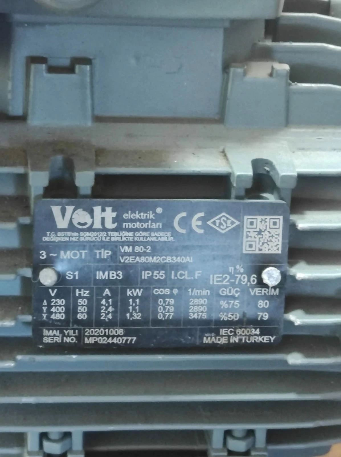

We are using a sensorless FOC algorithm. The motor is connected in a delta configuration with the IHM023.
  • DC bus voltage of our system: 318VDC
  • Input voltage: 220VAC
  • Motor parameters: in below image.
Using a voltmeter, we measured the voltage between motor phases A and B, which was 199V.
Additionally, we monitored the motor power using the motor pilot interface. At 2500 RPM, the motor consumes approximately 460W.

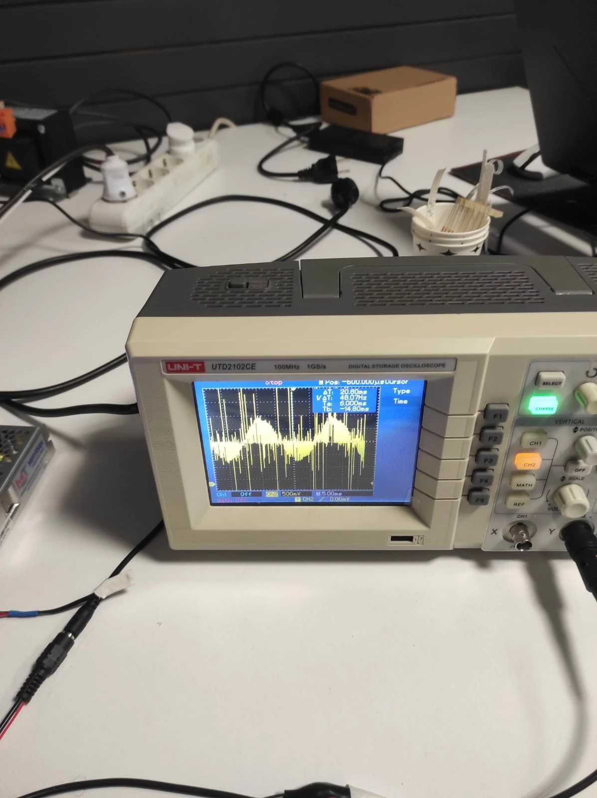

Please check the stator frequency... use a curent probe in 1 motor phase or at least an oscilloscope channel configured in frequency meter. From there you can deduct the frequency you apply in real time to the AC motor (Fstator 'mechanical' = Fstator measured / number of pair poles of your motor). FYI in no load condition you should have a rotor frequency close to the stator frequency (Frotor = Fstator * slip)
Say you have 1 pair pole, if you measure 2500/60 = 41.66 Hz on the stator whatever target you set above the 2500 RPM it means that the FW is clamping the speed to 2500 RPM, so you have to modify your FW in order to generate higher stator frequencies.

Hi @Floflo
I’ve measured the stator signal on the oscilloscope and observed a frequency of approximately 48 Hz.
This corresponds to a theoretical no-load speed of 2880 RPM for a motor with 1 pole pair.
In the ST Motor Pilot, the mechanical speed is 2494 RPM, which suggests a slip of around 13%, typical under load.
However, my speed reference is set to 3990 RPM, which would require a stator frequency of about 66.5 Hz.
Since only 48 Hz is being applied, it appears that the firmware is clamping the output frequency, preventing the motor from reaching the desired RPM.

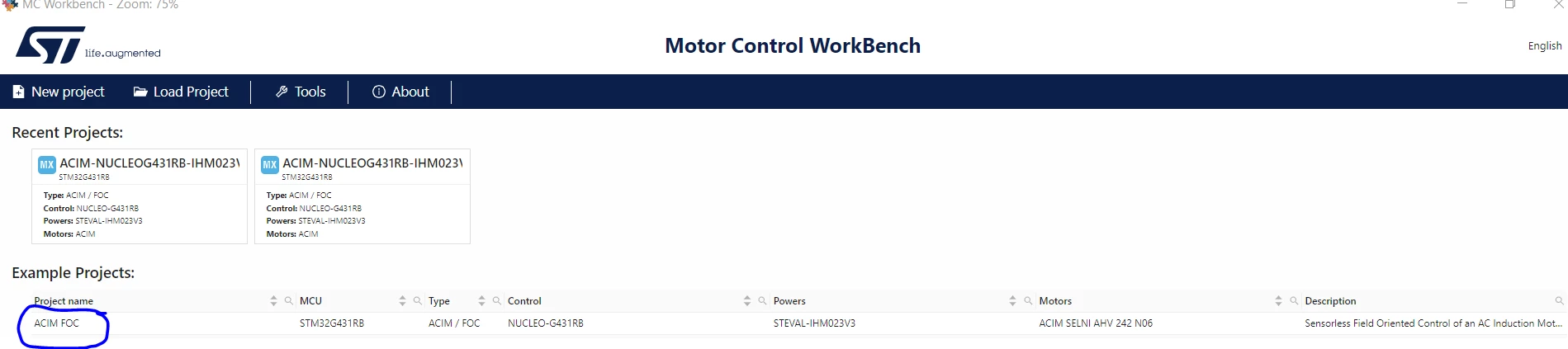

However, I would like to point out the following:
I am using the example provided by ST’s Motor Control Workbench in my project, as you can see in the screenshot.
I’ve also made some changes in the speed/frequency configuration settings there, but the motor’s stator frequency still did not change.

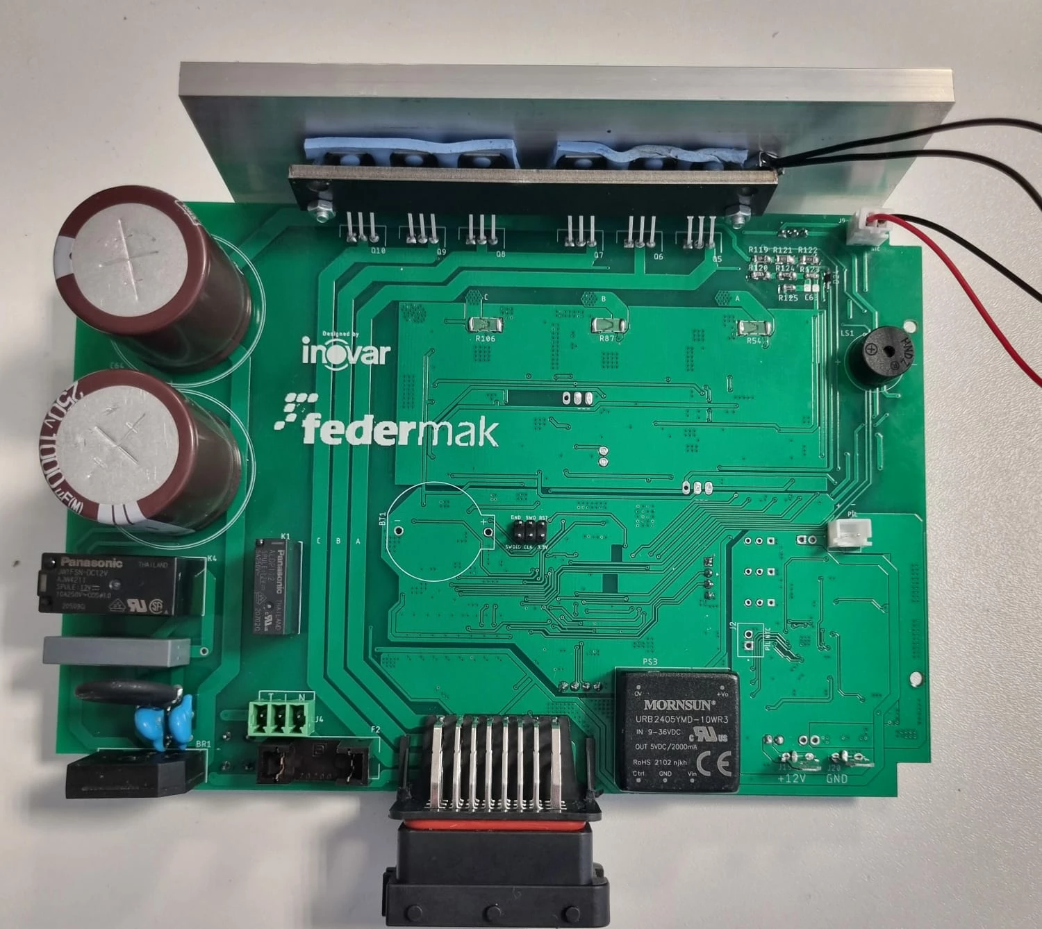

Explorer

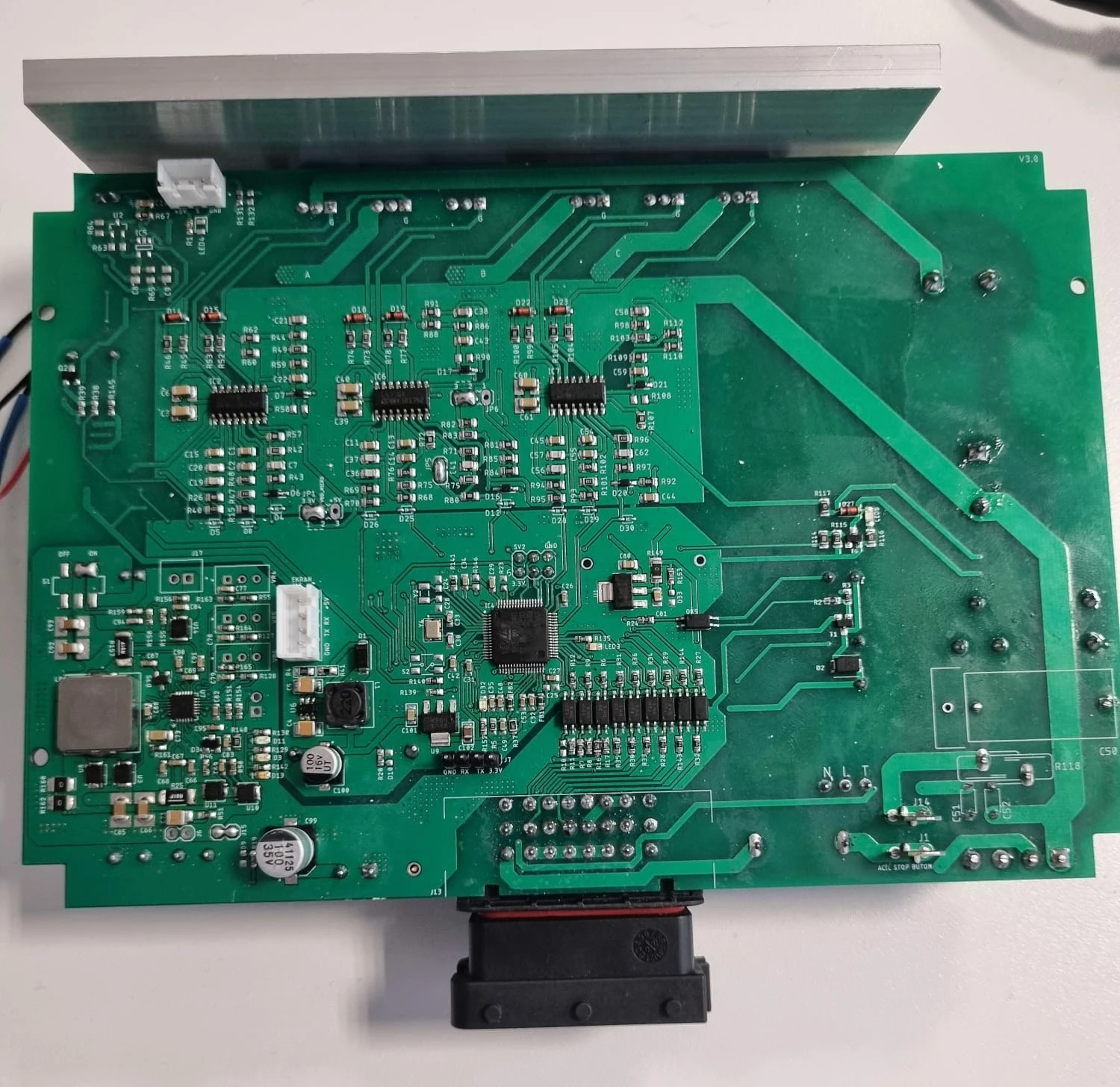

Hello @Floflo
As our software manager @Omer Ab  wrote before, we need to increase the motor speed to around 80 Hz. The motor used in the project can operate at high speed, there is no problem with the hardware or mechanics.  We will increase the motor speed to the highest level and start mass production of the device. I am sharing the final photos of the device below. Our device needs software support. Thanks

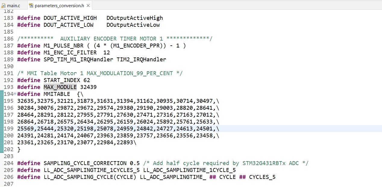

Senior III
/* MMI Table Motor 1 MAX_MODULATION_100_PER_CENT */
#define MAX_MODULE 28000
parameters_conversion.h file
28000 i used but it can go higher as well.

Max modulation value is 32,439 can we raise it even more?
Senior III
The maximum is 32767 you can try over modulation. I don't know the exact root cause I am telling based on my experience so you can decide to follow or not.

Omer Ab
Omer AbAuthor
@STuser2 @Floflo
I tried it, but I didn’t notice any difference.
