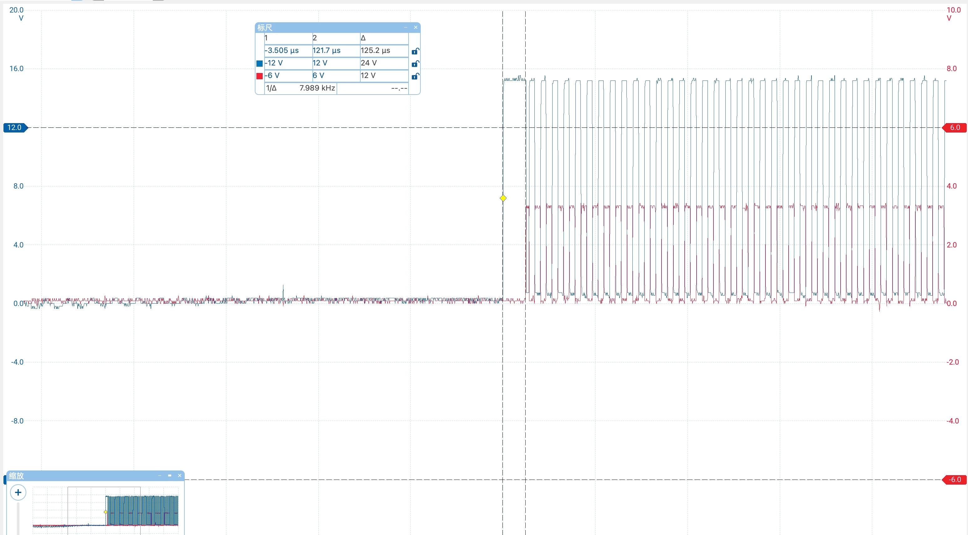

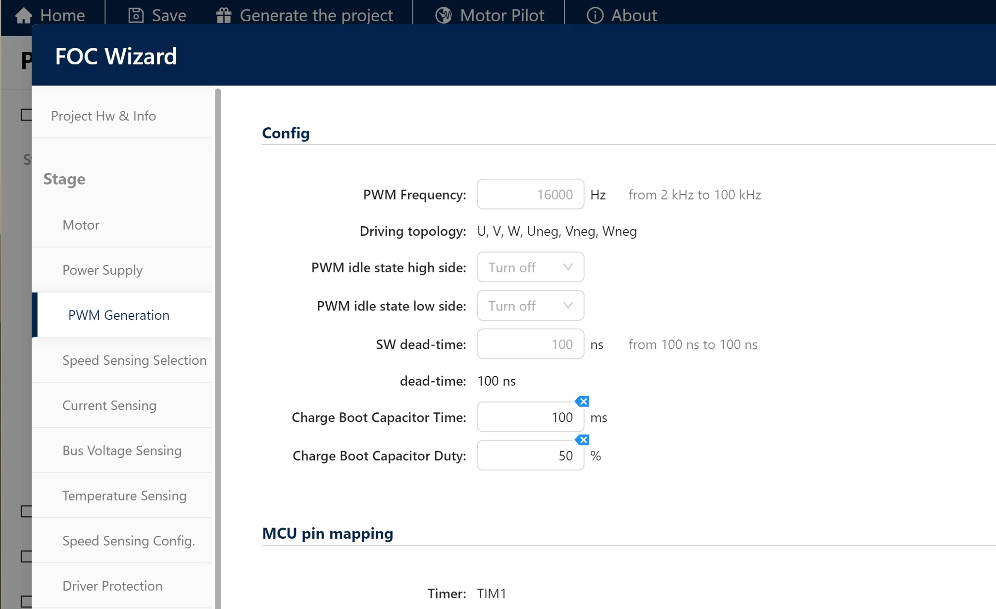

    I set the charge boot capacitor time with 100ms and the duty with 50%.
the picture is below,
and I captured the waveform by the scope. low side (green,16V from drive circuit),high side (red, 3.3V from MCU). the low side boot time is 125us. why is not 100ms?

    Hello @tonyqian926,
    Please, have a look the following application note.
    These Charge Boot Capacitor settings concern the phase on which only Low Side Switches are driven for capacitor charging before going to START phase.
