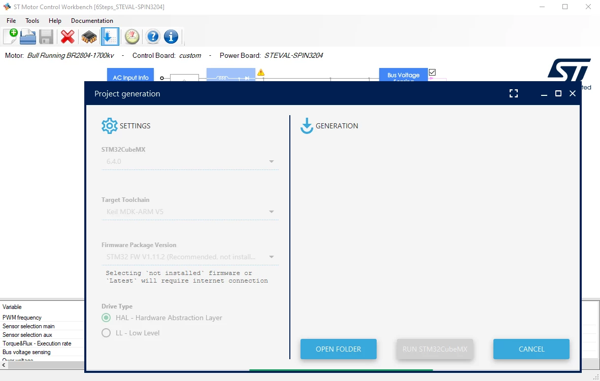

Dear Community,
In order to test the STEVAL-SPIN3204 kit, I installed the software environment as below:
  • Latest Java updated
  • Latest Keil MDK-ARM
  • Latest IAR EWARM
  • Latest STM32CubeMX
  • Latest ST Motor Control SDK 5.4.7
  • Firmware Package Version STM32 FW V1.11.3 and recommended STM32 FW V1.11.2
I tried anything any combinaison but the problem remains: when I click to "Update" the project "6Steps_STEVAL-SPIN3204" through the "Project generation" screen as recommended, nothing happens after a long time and nothing is generated; I have to click "Cancel" to exit.
Can you give me your opinion if something can be wrong in my procedure or your instructions please? I am sure that it is just a little thing blocking...
(on the picture, the Firmware Package Version is now installed but the result is the same)
Thank you in advance.

Did you solve the issue ? I have the same problem...
https://community.st.com/s/question/0D53W00001Dlo4f/st-motor-control-workbench-stuck-at-project-generation
Other uses says to downgrade CubeMX (see link).
Ronny Landsverk
December 9, 2021
Just downgraded to CubeMX v6.3.0 and now it works
