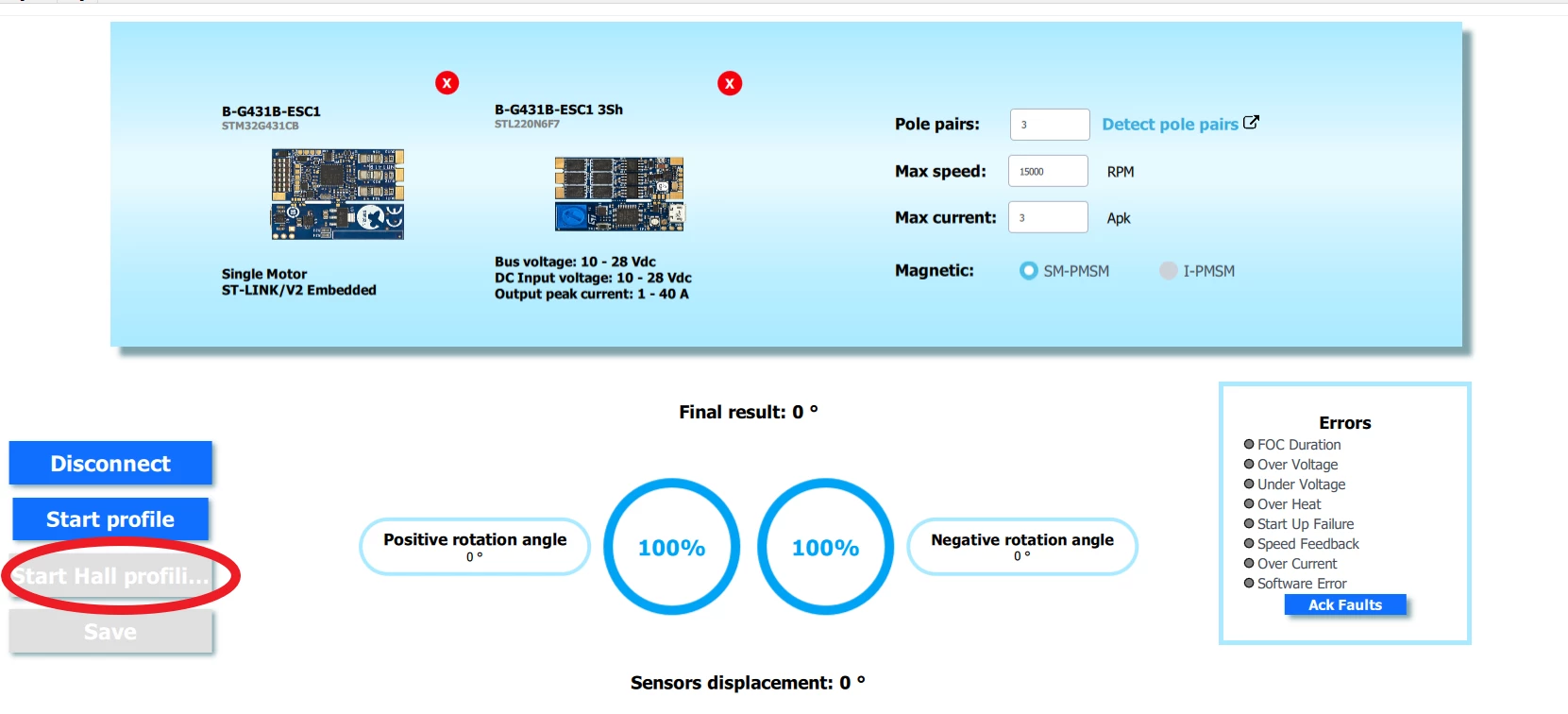

SamHansen42
Followup, the above code and post is based on MC SDK V6.0.0.
I see V6.1.1 has hall sensor built into profiler. I tried that, but problem is its greyed out.
_legacyfs_online_stmicro_images_0693W00000bj8kUQAQ.pngAlso, motor profiler was hard to get running see below:
Profiler gets stuck re-programming dev-kit as described here:
https://community.st.com/s/question/0D53W00002EtFP6SAN/how-do-i-operate-motor-profiler-from-motor-pilot-v115

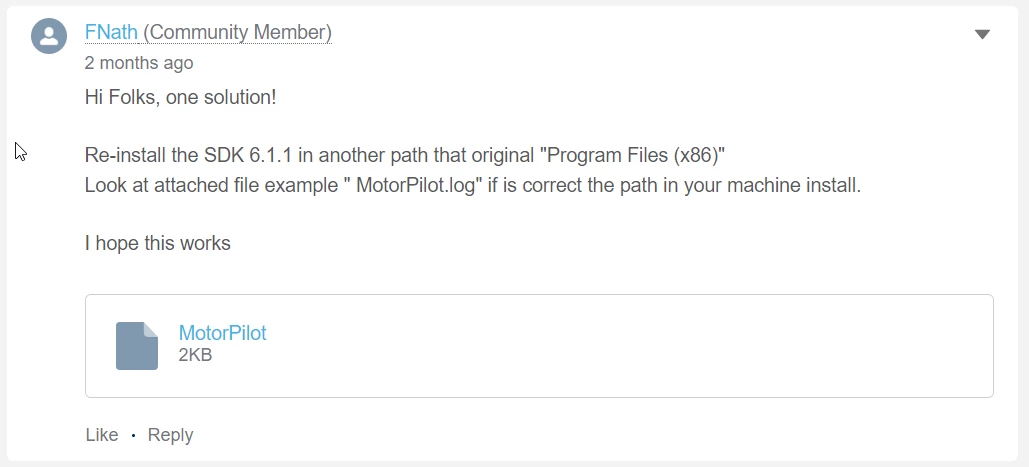

Profiler solution fix:
https://community.st.com/s/question/0D53W00002A1SntSAF/st-motor-pilotprofiler-will-not-connect
