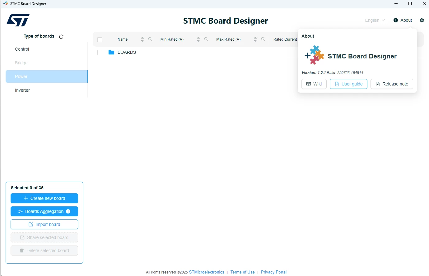

Hi @surendhar4046, are you using the STM32 MCSDK6.4.1 toolset for your custom motor control project?
The STM32 MCSDK6.4.1 toolset helps users create custom projects. A Board Designer tool, embedded in the MC Workbench tool, assists in creating the custom board ,json files required for the Motor Control software generation performed by the MC Workbench tool.
You can find the "user guide" in the "About > Documentation" section of the Board Designer tool, which provides guidance for the design process.
Also, I recommend loading STM32 boards that meet your requirements and reviewing their implementation.
Following link to STM32 MCSDK6.4.1 X-CUBE-MCSDK | Product - STMicroelectronics
