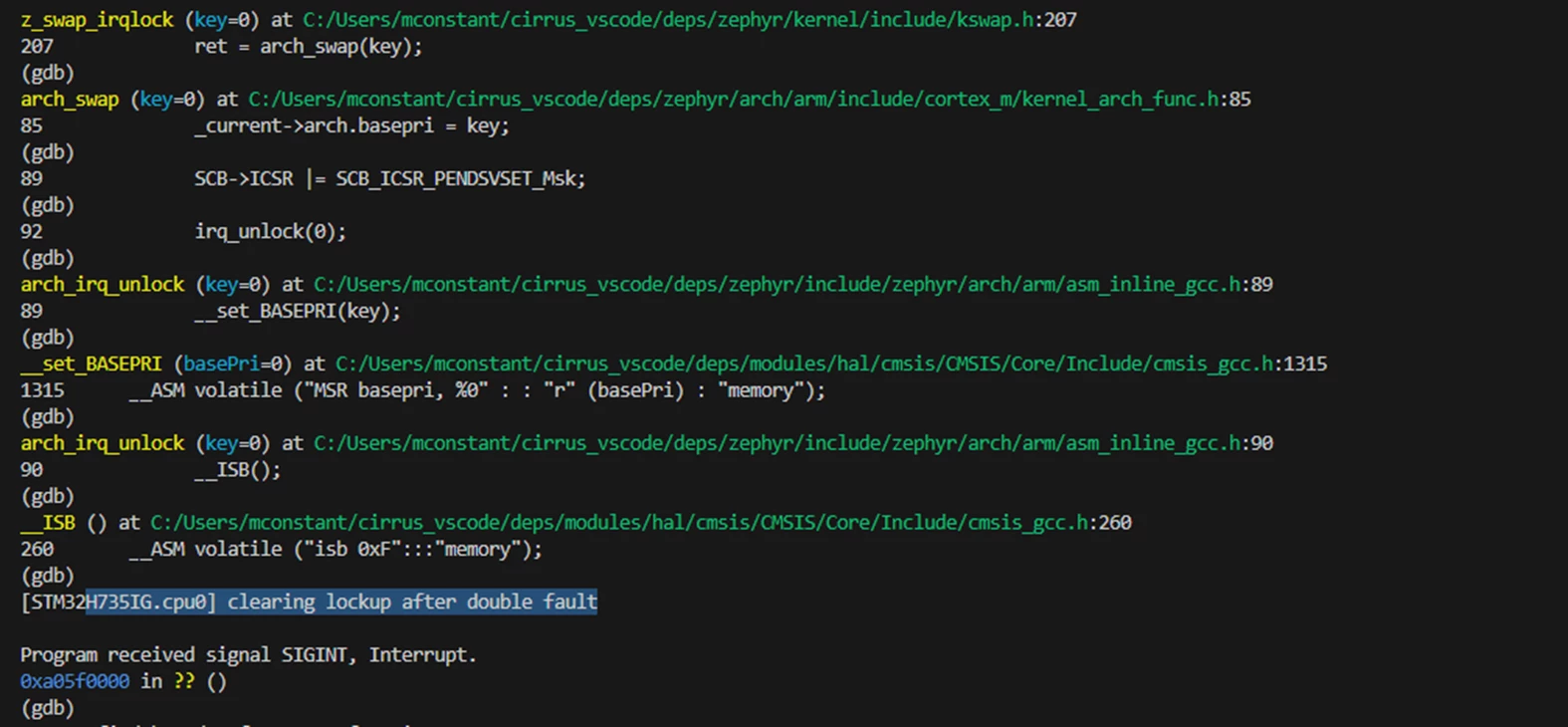

Zephyr with STM32H735g_disco board crashes when executing the z_msleep function
Project: samples/basic/blinky
board: stm32h735g_disco
I am using the latest Zephyr 4.1
If have a simple project `sample/basic/blinky`. Using the west command to compile the project, flash the board, debug the board with OpenOCD protocol.
Everytime I used the debugger (dbg), I am able to step by step the project until I reach the k_msSeep() function.
A friend of mine help me to debug it and we were able find that the system breaks as indicated in the picture below.
If I don't use the debugger DBG, then the software does not crash... It just work.

Here is the answer from ST Support.
Please ask the customer to add the following line to the prj.conf:
CONFIG_STM32_ENABLE_DEBUG_SLEEP_STOP
west build -p always -b stm32h735g_disco samples\basic\blinky
west flash
west debug
According to C:\zephyrproject\zephyr\soc\st\stm32\Kconfig:
config STM32_ENABLE_DEBUG_SLEEP_STOP
 bool "Allow debugger attach in stop/sleep Mode"
 help
 Some STM32 parts disable the DBGMCU in sleep/stop modes because
 of power consumption. As a side-effects this prevents
 debuggers from attaching w/o resetting the target. This
 effectivly destroys the use-case of `west attach`. Also
 SEGGER RTT and similar technologies need this.

IIRC gdb (or certain "target monitors") have problems with single-stepping thru some ARM assembly inlines. Unless you want to debug the debugger - avoid single stepping thru these things.

@Pavel A. It doesn't need to be single stepping. Just need to be in debug mode. The problem occurs with the `west debug` command or with the STM32CubeIDE. If I just flash it, it is working with no issue. Not very practical to design a new application.
