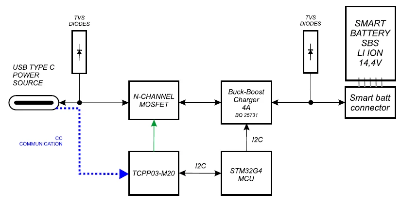

We plan to use STM32G0 mcu with UCPD interface and external TCPP03-M20 protection circuit with single bi-directional power path in our smart power bank with replaceable smart battery and USB-C PD dual role power port application. There will be one USB-C PD connector. And there will be TI BQ25731 Buck-Boost Battery Charge Controller with USB-C PD 3.0 OTG Output that is why we need single bi-directional power path

1) We plan to offer special non USB-C PD cable which allows to connect directly 12 - 20 V "not power delivery" power supply to USB-C connector. For this scenario, we would like to be able to control single bi-directional power path through TCPP03-M20 mosfet driver directly to enable this non PD power path to connect to battery charger (BQ25731), is it possible to do so?

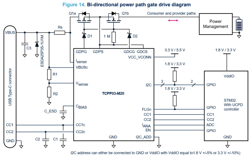

Interesting application, first, here is an example of two small signal Schottky diodes (D1, D2) to merge the paths while preventing reverse current flow and a 1 MΩ resistor for biasing.  Check datasheet for electrical characteristics.
TCPP03-M20 route the power from the power supply to the BQ25731 charger through I2C commands.
