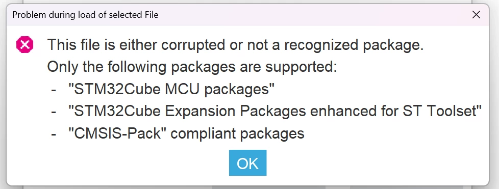

Currently, I am working on an STM32L432 microcontroller, emitting a 20 kHz sine wave. The code is relatively simple, although I am getting a slightly different frequency. I have been looking for solutions and found an embedded software package called RC-CALIB as a relatively cheap solution to this.
However, I cannot load the package on my CUBE IDE, even though the software was downloaded directly from the STM website. The latest version is from 2015.
Thanks for your time.

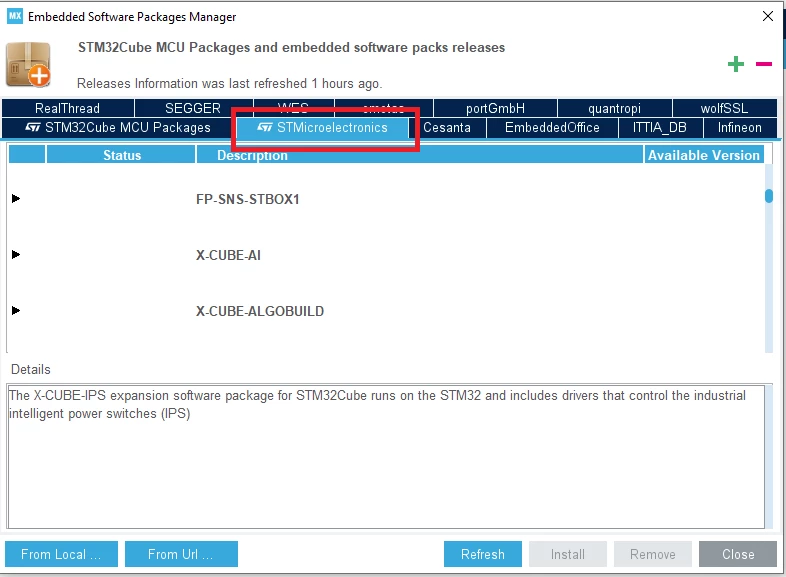

Hello @JavierRomann and welcome to the community,
How did you load that package to "CubeIDE"?
It's not available in the list of CubeMx: Software Packs / Manage Software Packs / STMicroelectronics:
Dec 2, 2024 10:44 AM UTC
Hello @mƎALLEm, thanks for your reply!
I load it via manually by the "From Local..." button. The expansion was downloaded via STM page https://www.st.com/en/embedded-software/x-cube-rc-calib.html.
Thank you very much for your time and assistance.
mƎALLEm
Dec 2, 2024 10:48 AM UTC
I don't think this is possible as CubeMx doesn't list it. Meanwhile, I will escalate your request for conformation.

mƎALLEm
mƎALLEmBest answer
Dec 10, 2024 9:34 AM UTC
Hello @JavierRomann ,
I've got the feedback. As I said as the package was not listed in Software Package in STM32CubeMx, it's not a standard CubeMx standard package. So you need to copy and add the files manually to your STM32CubeIDE project.
Hope that answers your question.
