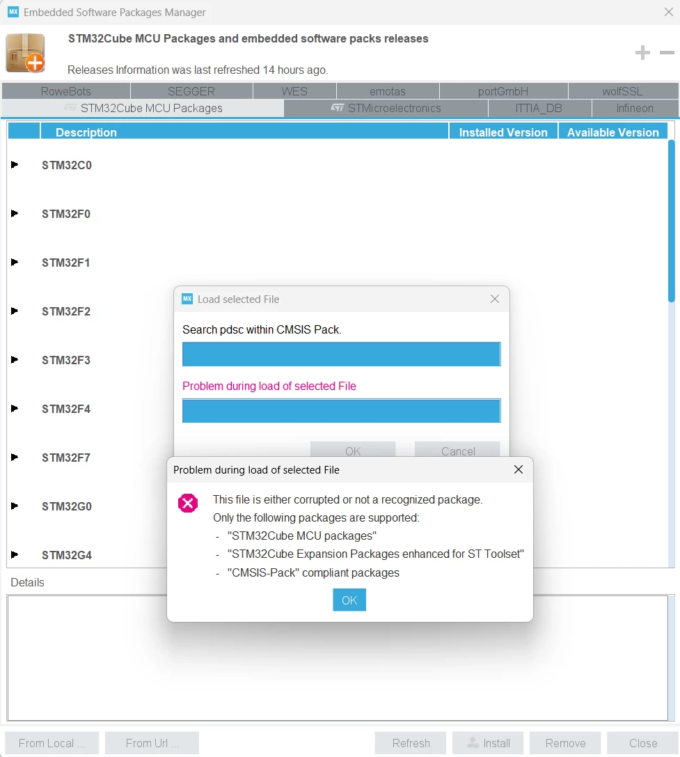

I need to import X-CUBE-OPUS on STM32CubeIde.
I have tried to use the embedded software manager in STM32CubeIde but it did not work.
My goal is to create a project from scratch and after add these middlewares.
What is the correct procedure to do it.
Thanks in advance.

    Apr 17, 2024 10:09 AM UTC
    Hello @Danielemazza,
    Further to your comment, I can confirm that the issue is related to the pack file. It does not include the STMicroelectronics. X-CUBE-OPUS.pdsc. Thats why the file is not recognized as a package.
    Thanks.
    Mahmoud.
