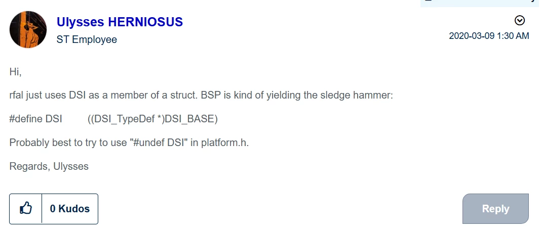

I think the reason is the STM32U599 having a DSI block and its HAL having a "#define DSI something".
Please check this. There was once a very similar request: compile-errors-importing-x-cube-nfc5-package
BR, Ulysses

Hi Ulysses,
Thanks for the response, I think you could be right, I applied your suggestion from the link you provided and now everything compiles error free.
Screenshot from your other ticket here in case anybody interested (basically use "#undef DSI" in platform.h. )
