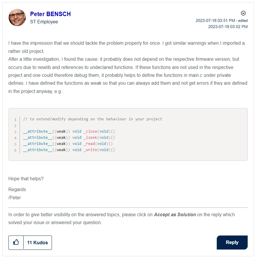

Hello @Julian1 ,
I think you're talking about Build warning, not build error. Could you please share a screenshot?
The problem that is causing the failed build was described in CDT (https://github.com/eclipse-cdt/cdt/commit/1b2472faff2028f0323ad5c5eb85565f81b89053).
For more information about these warnings and how fixed them, I advise you to check this post and precisely @Peter BENSCH answer.
I hope this help you.
Kaouthar
Julian1
Feb 20, 2024 7:00 AM UTC
Thanks for your reply .
Yes I have the same error output that Robin mentioned in the original post.
Can confirm that answer makes the warning go away.
Also, after being a bit more patient with testing the demo app, it *does* show the 3 second flash on completion... just much longer after the startup than I was expecting.
