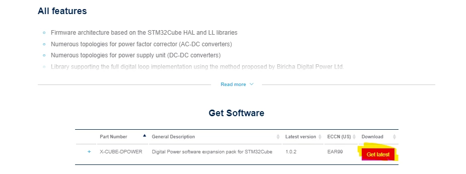

Hello @waaizkhan ,
I'm able to Add the X-cube-Dpower to a CubeMX using these steps:
1- download the package from St.com website from this link

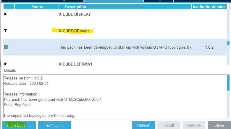

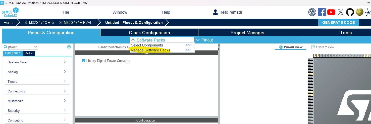

2- open cubeMX project and the select software packs manage software packs
3-select the from Local option and select the downloaded .pack file

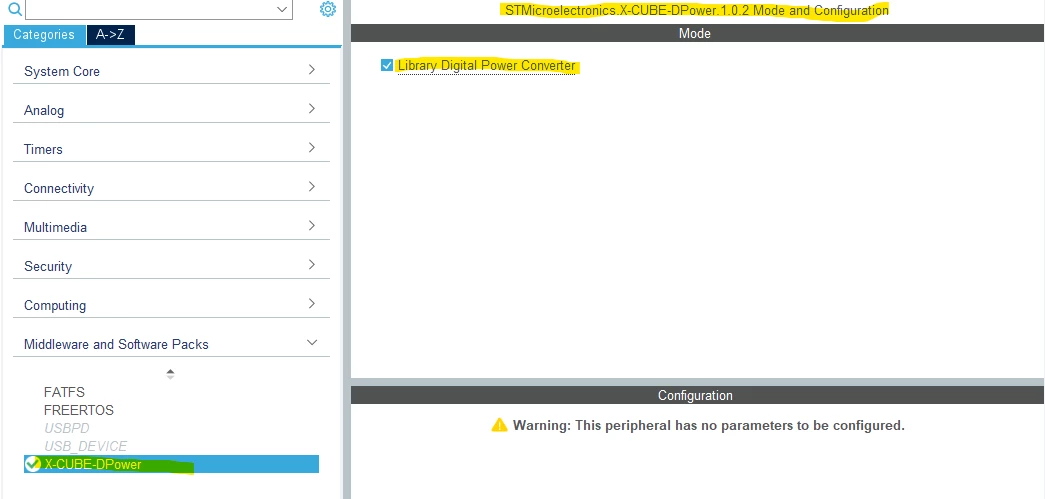

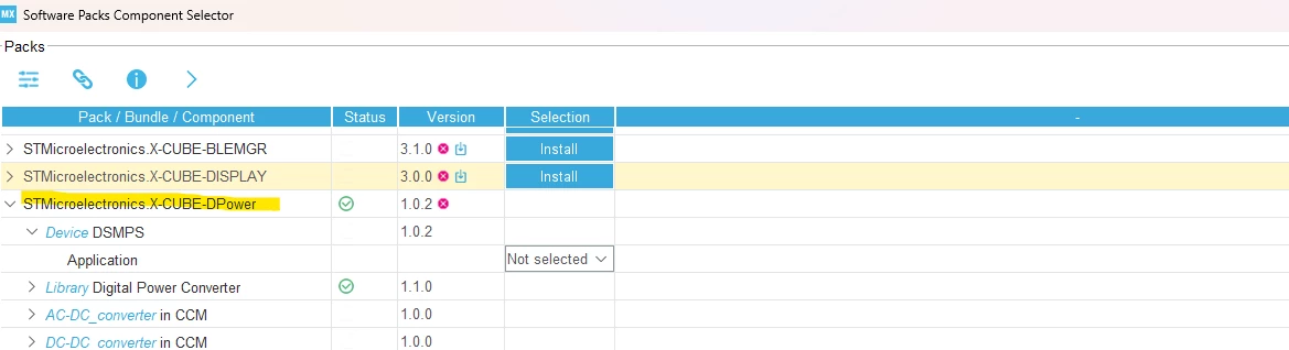

4-select software packs component selector and browse to the X-cube-Dpower section and select you desired functionalities it should know appear under middleware and software packs section in MX
hope this helps you.
