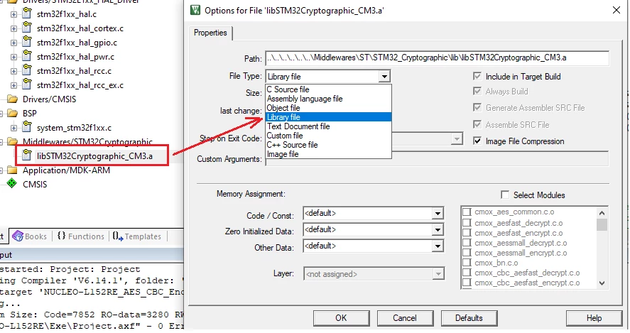

I've to add the x-cube-cryptolib to our application.
I added to include path, the file cmox_low_level.c and the library file libSTM32Cryptographic_CM3.a.
I get these errors:
\Middlewares\ST\STM32_Cryptographic\lib\libSTM32Cryptographic_CM3.a(1): error: A1167E: Invalid line start
\Middlewares\ST\STM32_Cryptographic\lib\libSTM32Cryptographic_CM3.a(2): error: A1167E: Invalid line start
\Middlewares\ST\STM32_Cryptographic\lib\libSTM32Cryptographic_CM3.a(3): error: A1167E: Invalid line start
\Middlewares\ST\STM32_Cryptographic\lib\libSTM32Cryptographic_CM3.a(4): warning: A1313W: Missing END directive at end of file
What can I do to fix these errors?
Thanks in advance!

Yes. I reproduced the behavior.
You need to select "Library file" instead of "Assembly language .." in this menu:
Right click on the library and select "Library file"

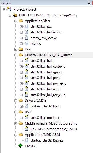

I suggest you to see how a project from Projects\NUCLEO-L152RE is constructed to inspire from it.

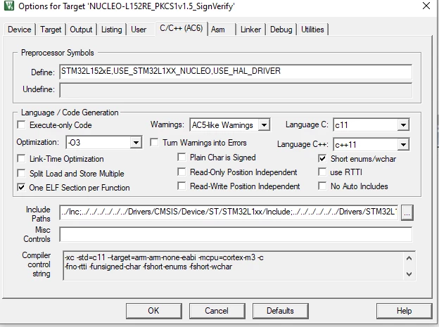

You need at least to have something like this:
Don't forget to define the include paths and the defines here:
KauneRAuthor
Feb 22, 2024 5:57 PM UTC
Without crypto lib, my application can be build and is running.
For the adding of the crypto lib, I added the include path, the c-file cmox_low_level.c and the lib a file.
Do I have anything else to add like defines for the crypto lib or an additional entry for the linker or compiler?

Feb 23, 2024 10:47 AM UTC
Yes, this helped!
For the first selection, a library .a file only could be taken as asm file. Change to library file, could build in the crypto library in my project.
