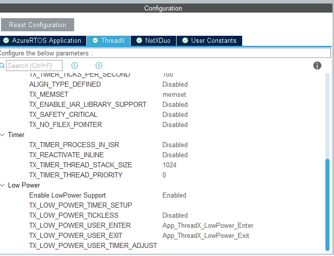

I successfully adapted the "Nx_TCP_Echo_Client" Sample from X-Cube_cellular 7.1.0 to fit my needs but right now am stuck at the final step, which is the low power mode.
I configured ThreadX for low power:
And implemented the following functions:

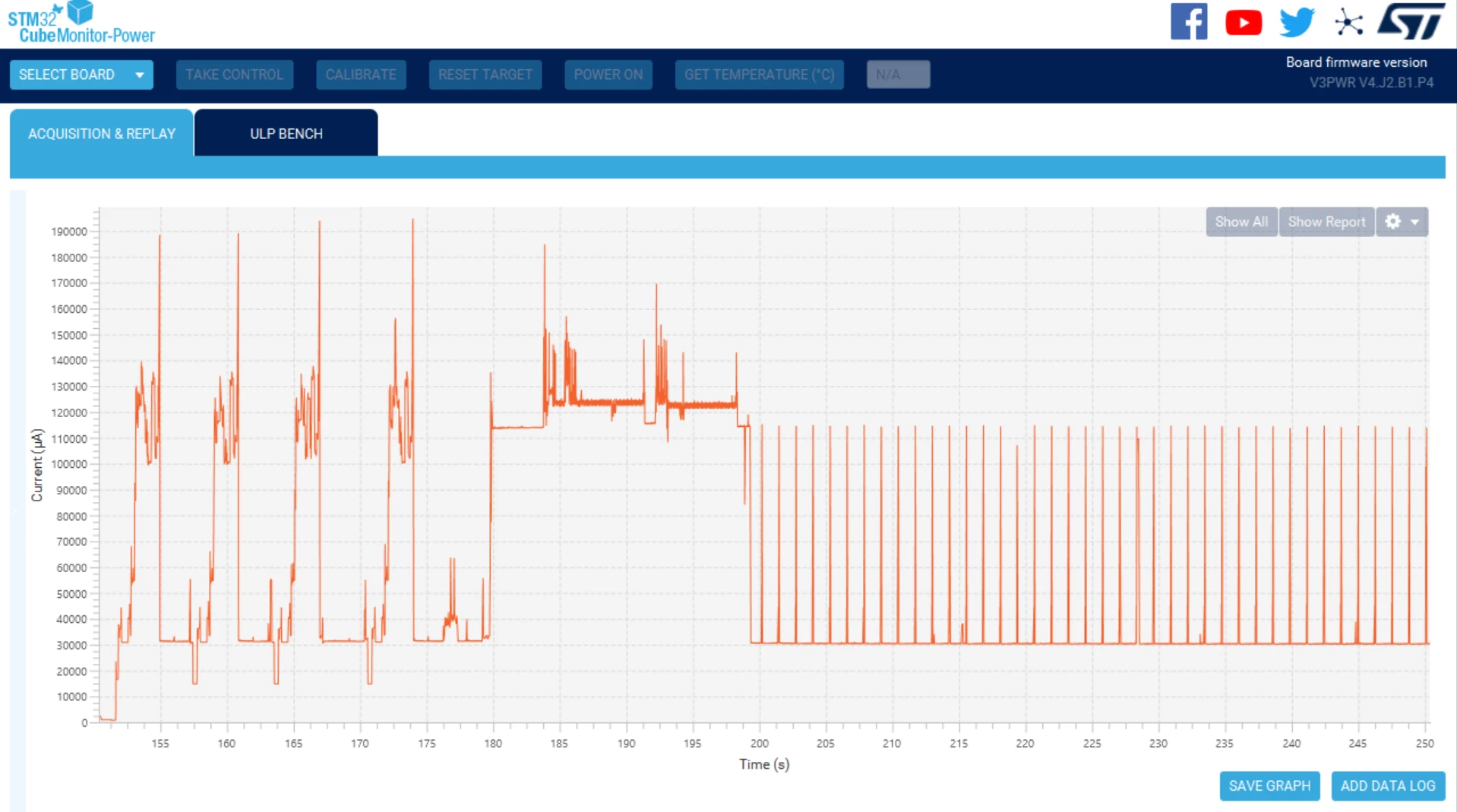

But still the board does not seem to go to sleep.
I use the StLink-V3-PWR and am measuring this current draw from startup to "sleep".
Any help or ideas would be greatly aprreciated.
