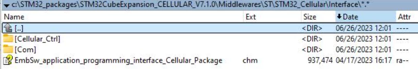

x-cube-cellular API Documentation
Is there a proper guide or documentation for x-cube-cellular? I want to test if I can send or receive data to a remote server and I am struggling to use the package API. In UM2426 it says "X-CUBE-CELLULAR Application Programming Interface available as file EmbSw_application_programming_interface_Cellular_Package.chm in X-CUBECELLULAR Expansion Package", but I couldn't find the file.
Any help is appreciated.
Imen.DBest answer
Jan 27, 2025 8:21 AM UTC
Hi @SSWM ,
I downloaded the latest release X-CUBE-CELLULAR v7.1.0
It contains the EmbSw_application_programming_interface_Cellular_Package.chm file under this path:
\STM32CubeExpansion_CELLULAR_V7.1.0\Middlewares\ST\STM32_Cellular\Interface\
Please download and use the latest version.

SSWMAuthor
Jan 27, 2025 10:17 AM UTC
Thank you so much!
