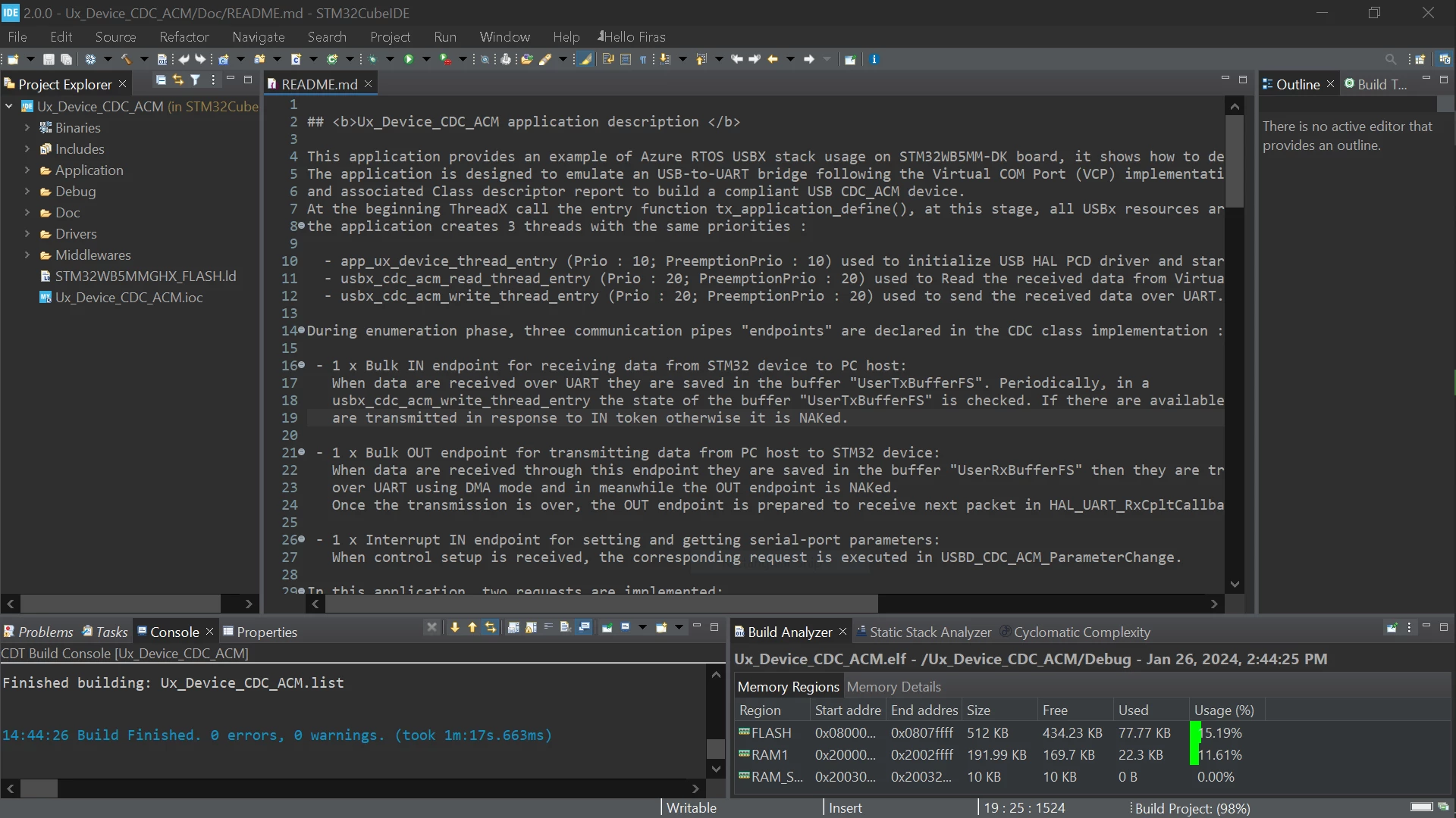

I have tried to reproduce on my side but the build is successful for the example :
  • X-CUBE-AZRTOS-WB version 2.0.0
    • STM32WB5MM-DK/Applications/FileX|ThreadX|USBX/* (3 examples)
If possible, to share steps to reproduce the issue. On my side I downloaded x cube package from MX tool without issues.
