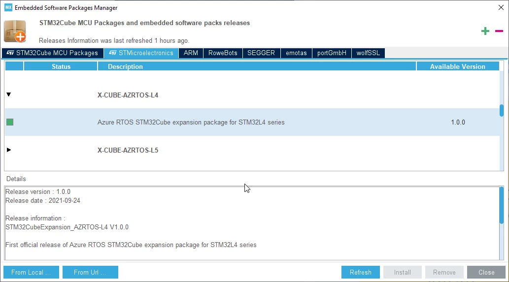

Installed the X-CUBE-AZRTOS-L4 package with the CubeMX "Install software packages" function.
0693W00000aHsnPQAS.pngLooks like it is installed.

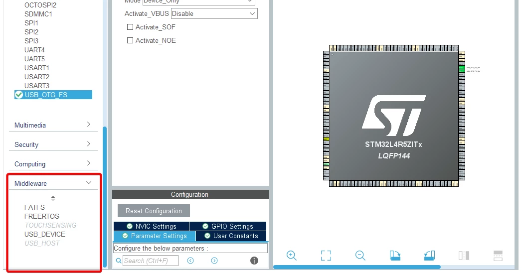

Starting a new Project with an STM32L4 device does not show the Azure RTOS Middleware options.
Bug or what I am doing wrong?!

Hello @Christopher Müller​ ,
To activate the X-CUBE-AZRTOS-L4, please refer to this training video.
This training is available to show in details how to setup and use the Azure® RTOS STM32Cube Packages.
When your question is answered, please close this topic by choosing Select as Best. This will help other users find that answer faster.
