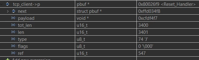

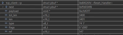

At line (tcp_client->p)= (p); when I debuged I came to know that values are not getting assinged.
Below are the screen shot.
since wrong values for all members getting assigned I am facing Hard fault issue. Is it structure alignment issue? I am using LwIP library for Tcp/Ip application.

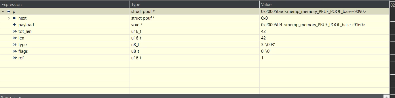

The first image you posted is too low-res to read.  It looks like it is showing the contents of "p" and might be OK if I read the fuzzy pixels right.  The second shows "tcp_client", I presume BEFORE it gets "p" assigned to it.  That looks odd, specially the pointers.  Where is "tcp_client" declared/defined?  It looks to be a global variable in the code you posted above.
Standard debugging applies here.  Does this fail on the 1st time through?  20th time?  Only after hours of running?  What do your other functions do with "tcp_client"?  And as a good programming practice, after you call pbuf_free() set tcp_client->p = NULL to help with future debugging and make it obvious if you try to use tcp_client->p again without allocating a new buffer.

Not sure which image you're complaining about. The resolution of the Yellow screen shot makes it unreadable.
What does the black one represent vs the yellow one. Problem is poorly expressed.

May 10, 2024 5:05 PM UTC
Appologise for given lack of information.
Buffer count is 100.
After executing the below statement
p = (pbuf_alloc(PBUF_TRANSPORT,buff_len,PBUF_POOL));
Yellow image is shown by debugger which is expected value,basically it's showing string length which is to be sent on ethernet.
But after that
(tcp_client->p)= (p); Is making problem.
The black screen image is showing garbage values even after executing it,I am complaining below black image.

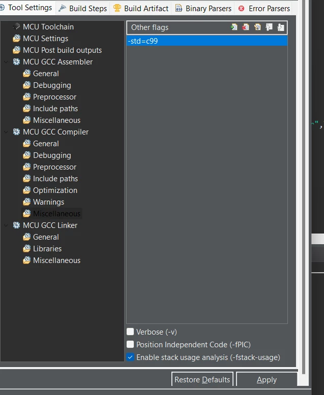

May 11, 2024 11:55 AM UTC
I did it in above comments.
pradeepwagreAuthorBest answer
May 15, 2024 2:12 PM UTC
Thank you for replying,I added this and then the similar structure assignment issue got solved.
