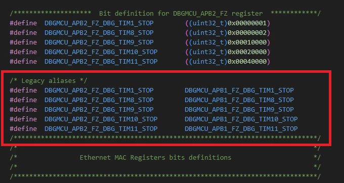

Wrong Code in STSW-STM32065 V1.9.0 stm32f4xx.h File
I found wrong code at
STM32F4xx_DSP_StdPeriph_Lib_V1.9.0\Libraries\CMSIS\Device\ST\STM32F4xx\Include\stm32f4xx.h file. Please see follow image:

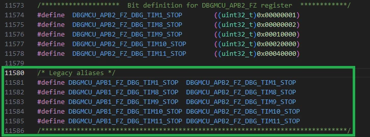

This part code will cause incompatible redefinition of macro warning and maybe another issues. I think these codes in red rectangle should change as follow image:

Hello @GhostLee and welcome to the ST Community :smiling_face_with_smiling_eyes:.
Thank you so much for reporting this.
I escalated your request internally to the concerned team for analysis and further investigation (through Internal ticket number: 175247)
(PS: Internal ticket number 175247 is only for reference, not available outside of ST)
Best Regards.
