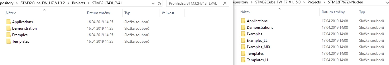

Apr 17, 2019 1:43 PM UTC
Hello @Pilous Droip​ ,
STM32H753 device is already supported in the STM32CubeH7 for HAL and LL drivers.
You can refer to the working applications applicable for STM32H753-EVAL:
STM32Cube_FW_H7_V1.x.x\STM32Cube_FW_H7_V1.x.x\Projects\STM32H743I-EVAL
Regards,
Imen

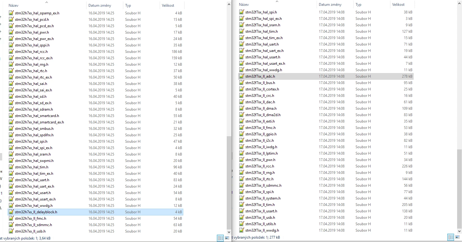

Pilous Droip
Senior
Apr 18, 2019 5:18 AM UTC
I don't know, but I see only this LL drivers.
For STM32H7
  • stm32h7xx_ll_delayblock.h
  • stm32h7xx_ll_fmc.h
  • stm32h7xx_ll_sdmmc.h
  • stm32h7xx_ll_usb.h
Where is RCC, I2C, SPI, UART, ... ?
I think I have to write my own.
It STM32H7 - STM32F7

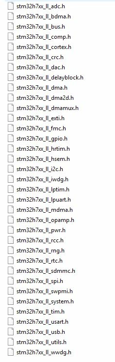

Imen.DBest answer
Apr 18, 2019 8:08 AM UTC
Hi @Pilous Droip​ ,
A new STM32CubeH7 V1.4.0 will be available in few days with new LL drivers.
Keep an eye out for the next update!
Regards,
Imen
