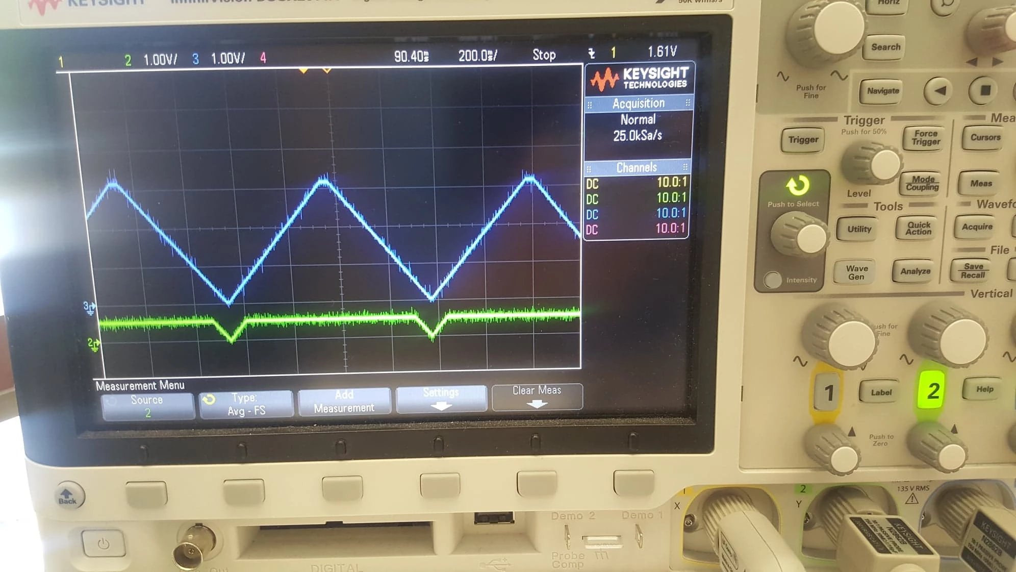

Why won't DAC channel 2 output higher than 0.5V on STM32L432 ?
I'm trying to use both channels of the DAC on STM32L432, but I'm having a very annoying issue: channel 2 only goes up to 0.5V! I think I've configured both channels correctly, because both channels output voltage that changes with my code... but the output just looks like this:
What I expected to see was two identical triangle waves... I'm sweeping an integer from 0-4095 and back down to 0, and sending it to both DAC's. I've tried multiple different commands to write the values to the DAC's, including:
HAL_DAC_SetValue(&hdac1, 1, DAC_ALIGN_12B_R, dac_val);
HAL_DAC_SetValue(&hdac1, 2, DAC_ALIGN_12B_R, dac_val);
and this:
DAC1->DHR12R1 = dac_val;
DAC1->DHR12R2 = dac_val;
and this:
HAL_DACEx_DualSetValue(&hdac1, DAC_ALIGN_12B_R, dac_val, dac_val);
All produce the exact same wave forms in the photo... Am I doing something wrong? Do I need to configure the two channels differently?

Well... 30 minutes after posting this question I figured out what the problem is... typical.
This behavior really looked like a short circuit to me, something like a diode holding the channel 2 output to near 0V... sure enough, looking at the schematic for STM32L432KC I find that PA5 is shorted to PB7 by solder bridge 18... removed the solder birdge and now it works beautifully.
FYI to anyone who comes across a similar issue in the future: the schematic for your board might be more important than you think!
