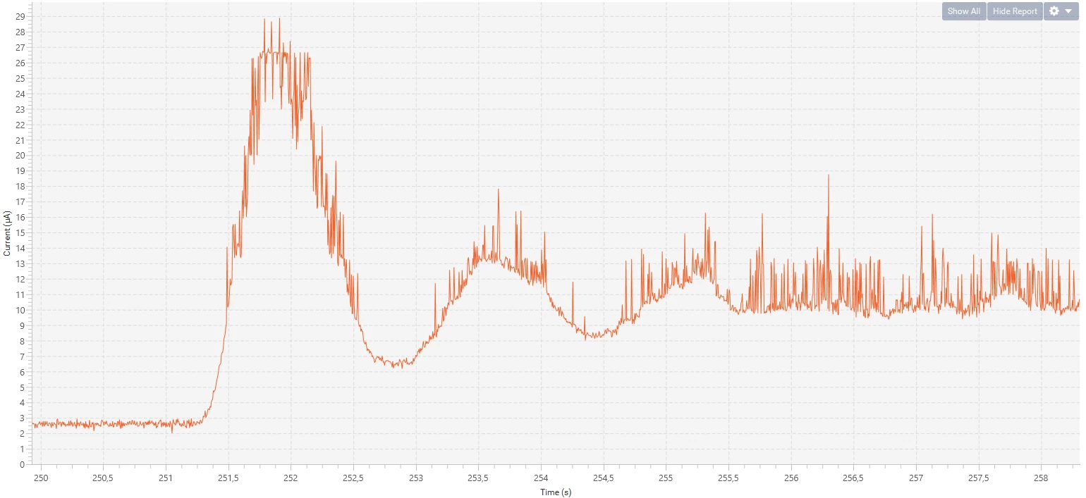

I used the STM32L073RZ and I used Stop mode for saving current.
And my problem is when I measured the current consumption of this MCU, I found arround 3uA during only 3 minutes after starting the Stop mode and then arround 15uA until my system wake-up, as you can see on the next chart the Current consumption measure with X-NUCLEO-LPM01A at the
increase of current
I already check the same result with an amperemeter.
It is like some internal power supply just turn on, but my system is always in stop mode.
I put the MCU in stop mode with the HAL driver function like that:

And just before Put the system in stop mode, I cut all interfaces that I don't need except one UART and 6 IO.
I don't that the problem come from the interface that I let awake because as I said, the
increase of current
is during the stop mode.
According to you, where could this increase of current come from during the stop mode?

Posted on December 07, 2017 at 20:49
I can't believe that such an oscillation (very nice capture!) may come from anywhere else than the external environment of the MCU.
Concerning the consumption, I bet that the MCU is somehow activated (from the outside) but is internally configured not to wake on that event. I/O configuration is likely to be the clue of this issue. How is it done ? Can you close all I/O and see how behaves the current ?

Posted on December 08, 2017 at 13:47
Oh, thank you,
I never thought that the MCU could be have this behaviour (activated by something not configure for)
I will try it.
