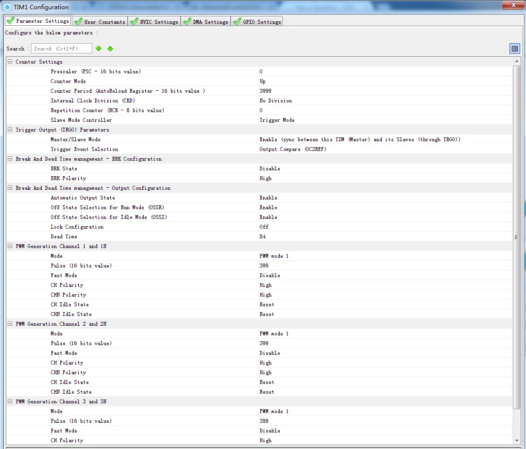

I generate the project using

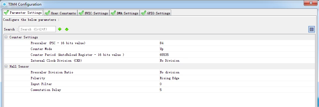

To control the bldc motor with hall sensors interface. The configuration is as below:
Refer to TIM4, which is set as the hall sensor interface, the detail configuration is as below:
Refer to TIM1, which is set as the PWM-generated interface, the detail configuration is as below:
After my debug, the motor can be driven. But I found the commutation delay doesn't work at all. So can anyone explain what the commutation delay means? Which event would affected by this delay setting? Why this delay doesn't work? I measured between Hall sensor input and TIM1_TRG_COM_TIM11_IRQHandler(), and I also measured between

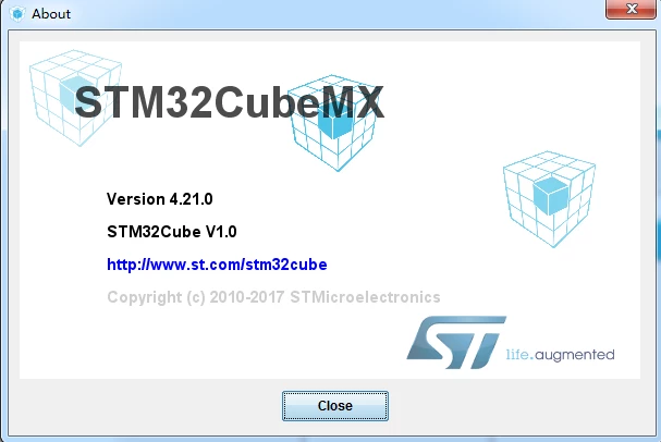

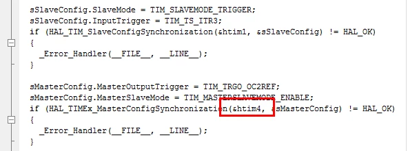

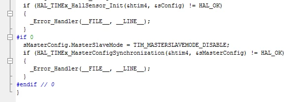

I would like to update the progress. I have found the root cause. It caused by STM32CubeMX tools. TIM1 shall be set as the slave timer while TIM4 shall be set as the master timer with OC2REF to TRGO. I wish ST guys would fix the bugs to let function of commutation delay go.
B.R.
Jason
