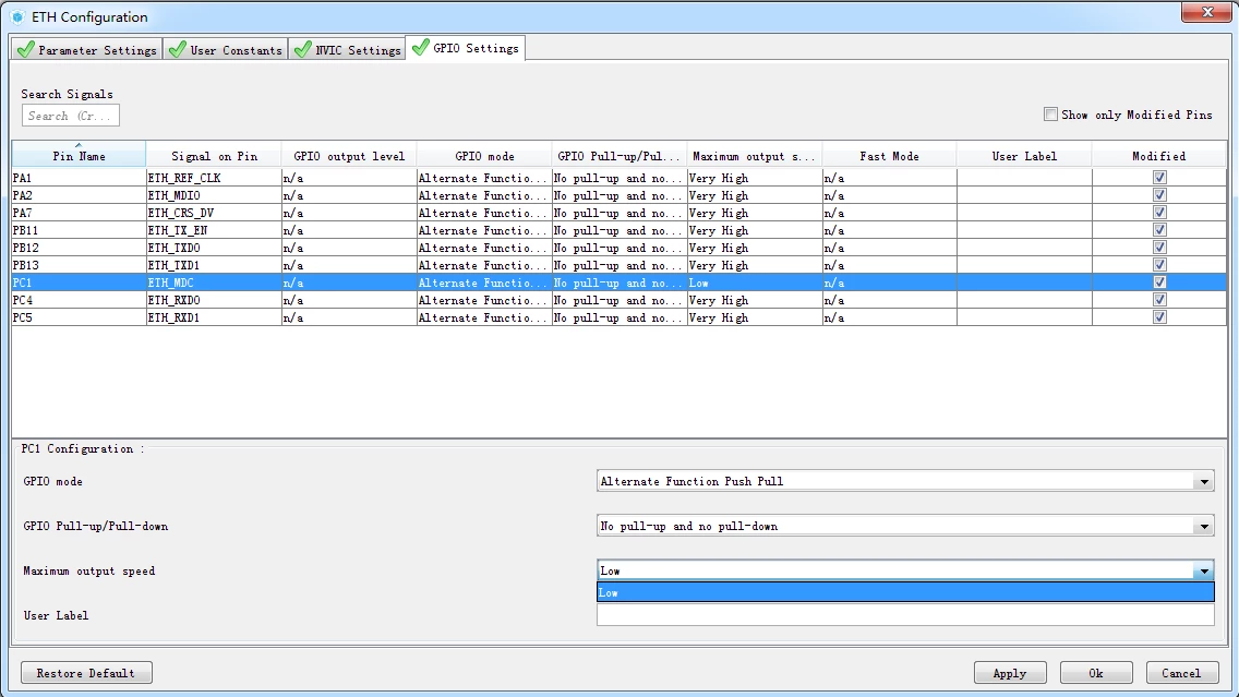

Hi all:
    I using cubemx to config stm32h743 eth, why pc1 can not set output speed to very high, the pc1 can only select low, not like other pins.
Thanks.
#stm32h7-ethernet

Doesn't MDC clock at 2.5 MHz max, what would be the value of aggressively slewing it other than generating unnecessary ringing and noise?

Thanks Clive Two.Zero.
