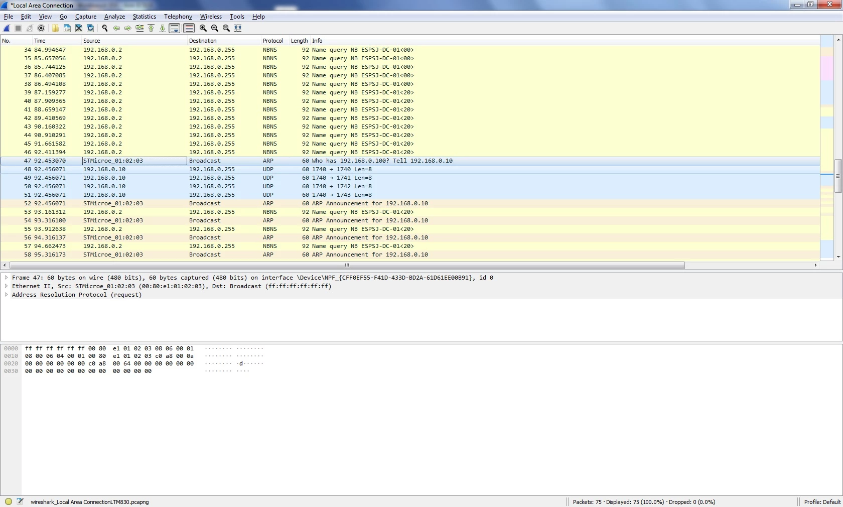

GJohn
GJohnAuthor
Jun 3, 2021 10:31 PM UTC
Actually, I can provide screen captures of the ARP transactions. Your bulletin board does allow posting of jpeg's.
Apparently, I can only attach one file to a message. So I'll need to generate two messages
Some related information:
PC is at 192.168.0.2
Gateway is 192.169.0.1 (none present)
data acq unit is at 192.168.0.100
Controller is at 192.168.0.10
Netmask is 255.255.255.0
ARP requests are at lines 7 (PC) and 47 (Controller)
waclawek.jan
waclawek.janBest answer
Jun 4, 2021 5:19 AM UTC
Your problem is probably something else, not the padded ARP packets. See explanation e.g. here, why you think PC is sending an unpadded packet ("Wireshark is lying").
GJohn
GJohnAuthor
Jun 4, 2021 10:57 PM UTC
You hit it on the nose. The link in your response describes my problem exactly. My network is connected together using an unmanaged hub. So the data acq module's ARP reply to my controller isn't visible to Wireshark. I was able to verify that my data acq module is responding as designed to my controller's ARP request. And I wasn't aware that Wireshark reports the wrong frame length for packets originating on the PC that Wireshark is running on.
Thank you everyone for your assistance is resolving this issue. Your assistance is greatly appreciated. George
