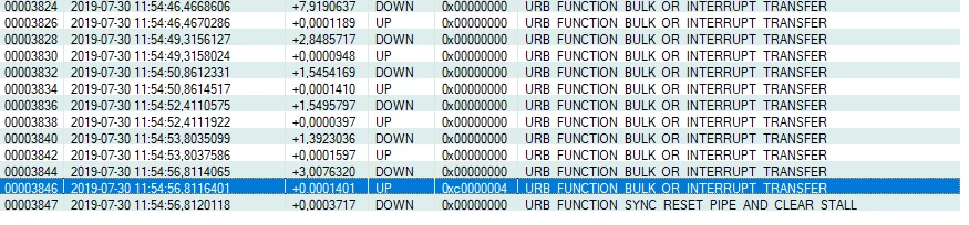

This is working 5 to 10 times but suddenly the MCU does not respond normally. Instead of sending the next 60 characters it responses with status 0xc0000004 - STALL_PID.
Why does the MCU send a STALL?

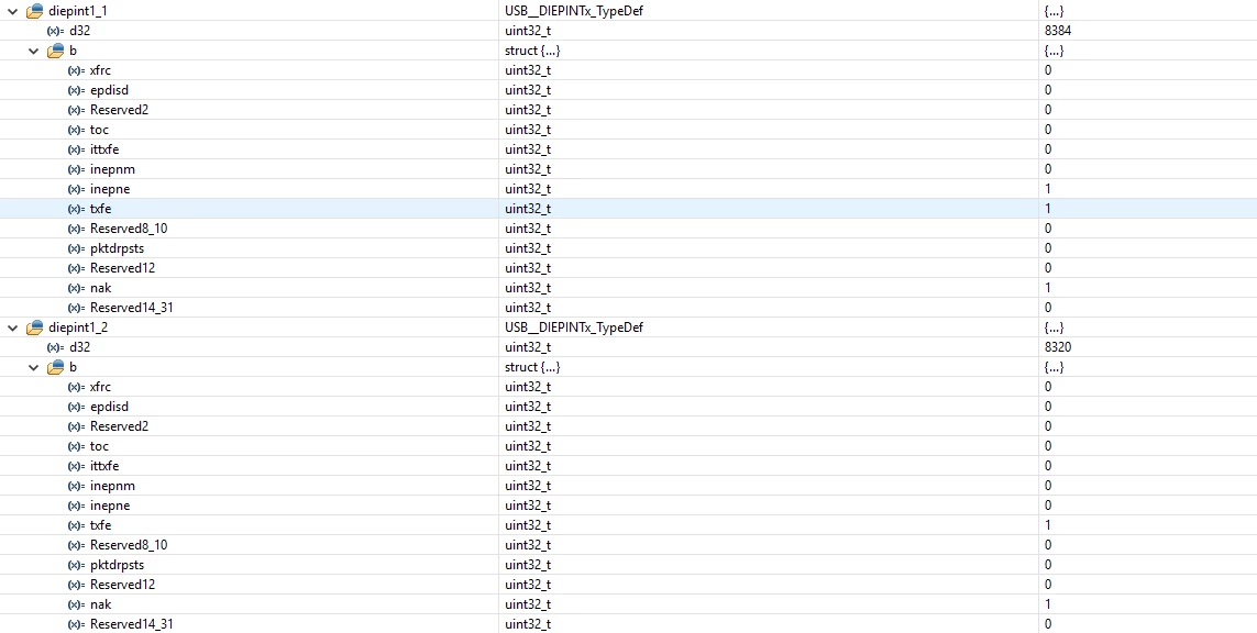

DIEPINT before and after:0690X000009Zcj7QAC.png

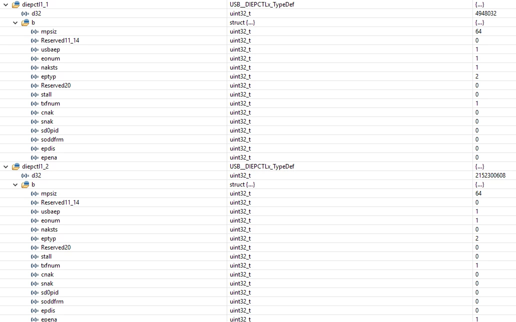

DIEPCTL before and after:

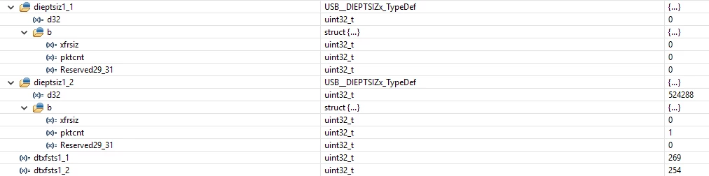

DIEPTSIZ & DTXFSTS before and after:

Register content before and after failed response.

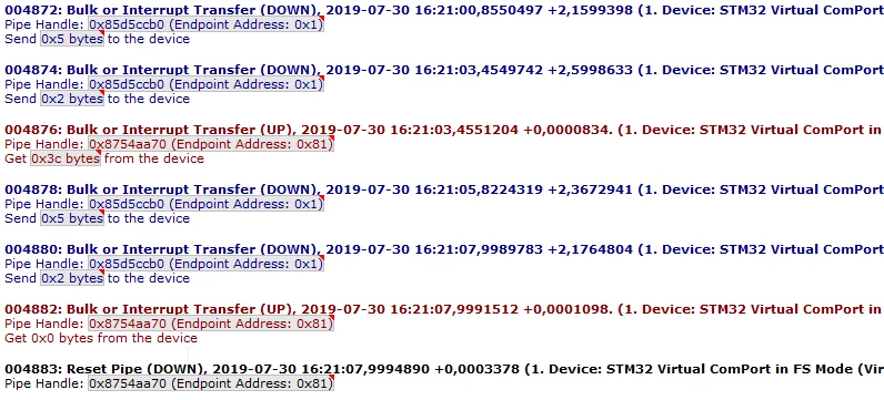

  1. Every transfer is initiated manually by sending 5 characters to MCU. Before the last transfer I don't see any STALL or something irregular.
  2. I'm not 100% sure it is a real STALL, because this information I got only from Device Monitoring Studio. The flag in DIEPCTL doesn't show STALL. I thought it could also be some automatic feature like:
"Bit 2 NZLSOHSK: Non-zero-length status OUT handshake
The application can use this field to select the handshake the core sends on receiving a
nonzero-length data packet during the OUT transaction of a control transfer’s Status stage.
1: Send a STALL handshake on a nonzero-length status OUT transaction and do not send
the received OUT packet to the application.
0: Send the received OUT packet to the application (zero-length or nonzero-length) and send a handshake based on the NAK and STALL bits for the endpoint in the Device endpoint control register."
Thank you for USB beagle hint. I thought I could avoid it)

The behavior is the same after ca. 10 successful transmissions. And: the STALL is detected after transfer load:

I should mention, the STALL response I see in Device Monitor Studio, whereas MCU shows this error as ITTXFE for EP1.
