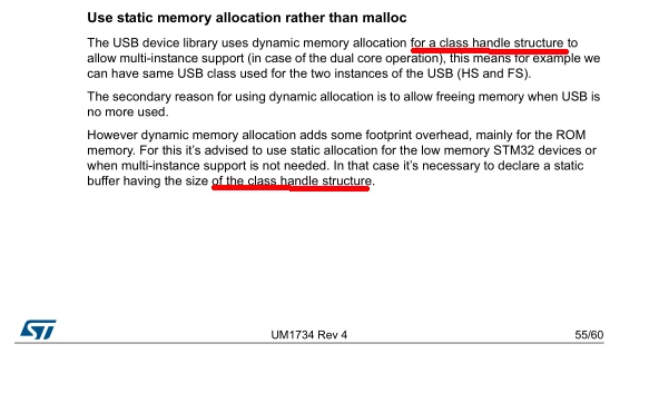

And, actually, UM1734 says exactly that:

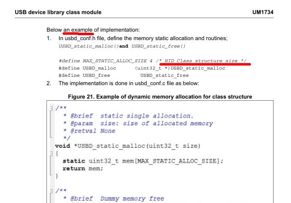

and, at the next page, it clearly says, that what's shown is an example, particularly for HID (where the respective class struct, USBD_HID_HandleTypeDef, as defined in c:\wek\stm32 misc\STM32Cube_FW_F4_V1.21.0\Middlewares\ST\STM32_USB_Device_Library\Class\HID\Inc\usbd_hid.h, consists of four uint32_t(*) - that's why uint32_t was chosen as the "unit" for that particular case):
and of course it's then the responsibility of the user to modify the example for *his* usage case - and that may be a single class different from HID, a compound of classes, or - as mentioned in UM1734 above - the same class in multiple USB device instances (using OTG_FS and OTG_HS).
Yes, the documentation may have been cleaner - there's *always* room for documentation enhancement - but I don't think this is the most urgent case for it.
(*) To split some more hair: there are 3 explicit uint32_t and one enum variable in that USBD_HID_HandleTypeDef struct. While the C standard allows width of enum to be implementation defined, it most probably will be 32 bits compiler targeting 32-bit processor, by default; and even if not, it's highly unlikely it will be *more*.
