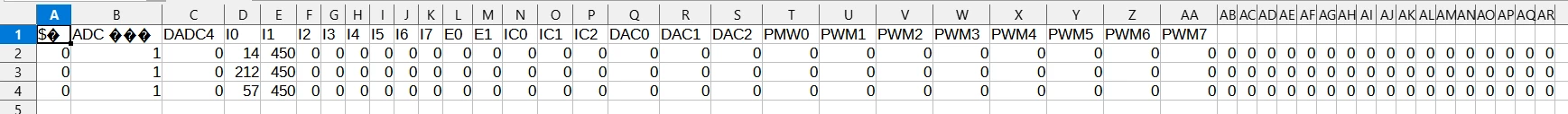

Writing garbage values:
If I write a text string for example this
STM32_PLC_SD_Write_File("Hour,Minute,Second,Millisecond,");
STM32_PLC_SD_Write_File("ADC0,ADC1,ADC2,ADC3,ADC4,ADC5,ADC6,ADC7,ADC8,ADC9,ADC10,ADC11,");
	STM32_PLC_SD_Write_File("DADC0,DADC1,DADC2,DADC3,DADC4,");
	STM32_PLC_SD_Write_File("I0,I1,I2,I3,I4,I5,I6,I7,");
	STM32_PLC_SD_Write_File("E0,E1,");
	STM32_PLC_SD_Write_File("IC0,IC1,IC2,");
	STM32_PLC_SD_Write_File("DAC0,DAC1,DAC2,");
	STM32_PLC_SD_Write_File("PMW0,PWM1,PWM2,PWM3,PWM4,PWM5,PWM6,PWM7\n");
/* Return -1 with End of File (EOF) */
static FIL *fil;
int STM32_PLC_SD_Write_File(char text[]) {
	return f_puts(text, fil);
Then I got this
$� ADC ��� DADC4 I0 I1 I2 I3 I4 I5 I6 I7 E0 E1 IC0 IC1 IC2 DAC0 DAC1 DAC2 PMW0 PWM1 PWM2 PWM3 PWM4 PWM5 PWM6 PWM7

This is a result when I do a "successful" logging process.

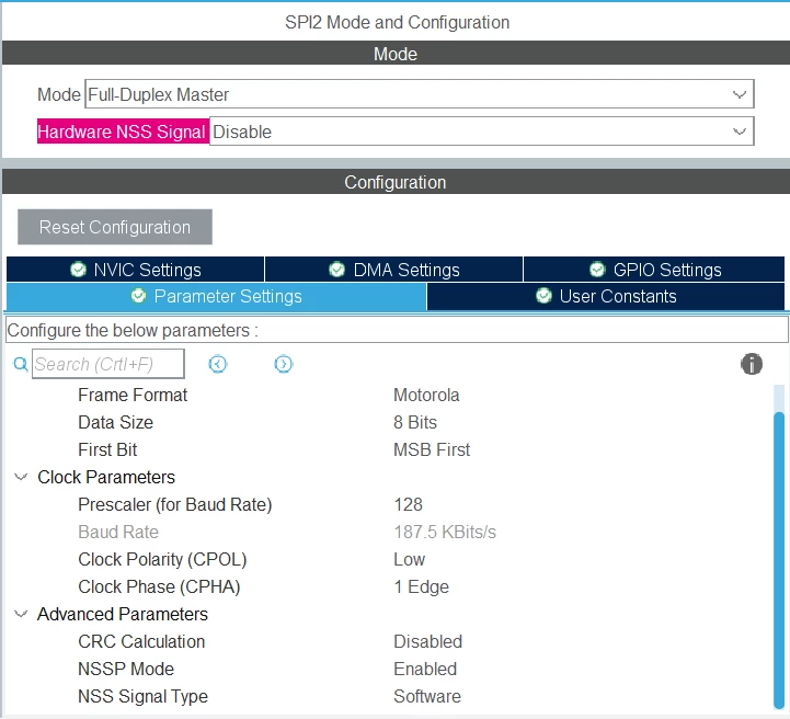

My SPI settings:
I'm using SPI for writing and reading to the SD card.
0693W00000D0tFIQAZ.pngThis is my FATFS configuration
