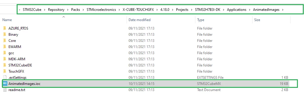

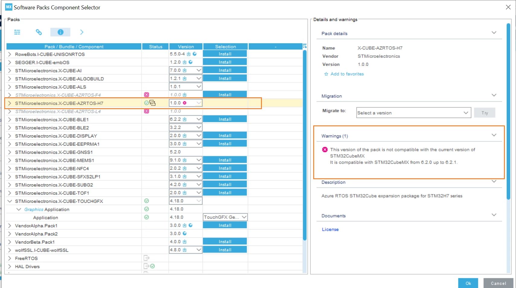

Otherwise, X-CUBE-TOUCHGFX pack come with a an example using STM32CubeMX as well as Azure RTOS. The AnimatedImages project is based on STM32H7B3I-DK board, but you can mimic it in order to use it with your STM32H750B-DK Board.
0693W00000GX6FDQA1.pngThis project is using an old version of X-CUBE-AZRTOS-H7 (1.0.0) which is compatible with the old STM32CubeMX version (6.2.1).
