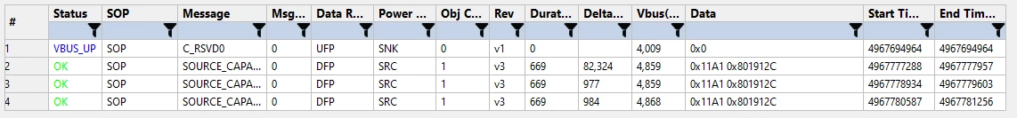

Why do I not receive a USBPD_NOTIFY_SRCCAP_SENT notification?
I am trying to set up a sourcing power delivery port on an STM32G0 system. I have set up switching of VBUS, and when I connect up a sinking device my system detects it, sets up VBUS and starts sending source capacity messages.

Using a PD analyzer I can see that VBUS goes up and three source capabilities messages are sent, but that is where the process hangs. Nothing happens and I do not receive a USBPD_NOTIFY_SRCCAP_SENT notification, presumably because the source capabilities messages never get acknowledged by the sink device.
I can see that the USBPD_CAD_Task keeps running (removing cables also triggers new activity), and I do not see any error handling calls. Comparing my code to stm32 source port example code, there are no differences that I can find that would explain this behaviour.
It looks like something hangs in some state machine while sending SRC_CAP messages, but I have no clue where to start searching for where the process fails.

Hello @Lvan .4​
Did you activate the trace tool that we provide ? It would help for debugging.
See this link in our wiki : Tracer tool
Because in the trace you shared we don't see the GoodCRC message, so we cannot be sure that your sink device got the messages.
Once you have the UCPD monitor in place you could share your debug trace here, so we can help.

Hi Nicolas,
Yes, my issue is solved. I followed the steps in this example, but this skipped setting up a call to USBPD_DPM_TimerCounter. I also figured that all timing related things were taken care of because I set up a USBPD timebase in CubeMX and the Sink part of my USBPD stack was working fine.
I later stumbled upon this function and noticed it had no calls at all, so I put it in a systick handler and that did the trick.
Of course, right after the fact I did come across this in the FAQ section on that same wiki (But under a slightly different problem description 9.10 Why is the PD message not sent by the stack? which is why I glossed over this the first time I went through this FAQ.. I wás seeing PD messages..)
