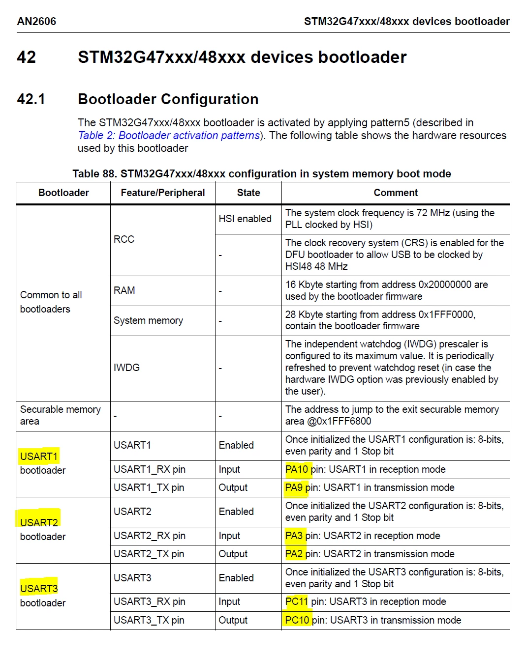

which USART can I use for bootloader?
I can see in the datasheet of STM32G474CE that I can use USART for reprogramming the Flash memory, but I am trying to understand which one?
In STM32F4 I can use USART1 and USART2, is it the same here?
Thanks.
TDKBest answer
Jul 26, 2021 10:48 PM UTC
USART1, USART2 and USART3 are available. The details are in AN2606.

What does App Note AN2606 say for your part?
TDKBest answer
