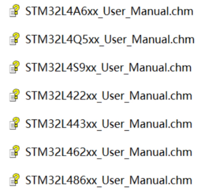

Where is STM32L431CCT6 HAL API Manual
I am find STM32Cube\Repository\STM32Cube_FW_L4_V1.18.0\Drivers\STM32L4xx_HAL_Driver, but I don't know want is STM32L431 Manual

    Wshuo.1Author
    Mar 12, 2024 2:04 AM UTC
    Thank you for your quickly reply.
    I finded UM 1884, this document is tell my which APIs are used in specific places.
    But I think I need chm format files, it can let me serach very quickly.
    So if I want to check API in chm format, want chm format file more likely STM32L431CCT6 MCU in my question image?
    Patrice LF
    Patrice LFBest answer
    Apr 19, 2024 2:03 PM UTC
    Hi @Wshuo.1
    STM32L431CCT6 belongs to the STM32L4 Access Line as visible on
    https://www.st.com/en/microcontrollers-microprocessors/stm32l4-series.html
    It is a less-feature version of the STM32L433/STM32L443 products (STM32L443 being the STM32L433 with HW crypto/hash functions). You can then refer to STM32L443xx_User_Manual.chm listing all APIs considering that the ones specific to crypto/hash functions and peripherals not present on STM32L431 are not available for your device.
    Regards
    Patrice
