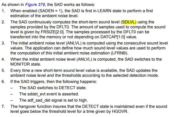

just as the subject line asks, I am trying to figure out where the ADF stores its Ambient noise level (ANLVL) or if there is already a callback for that value. I was having trouble locating where this value is stored. Is there a set register location I can call or a set variable? In addition, where would the sound level (SDLVL) be stored? Any help with this would be much appreciated.

Please refer to the chapter ADF in the product reference manual RM0456.
Here an overview of how SAD works:
In the reference manual, you will find more details about the registers as well as SDLVL & ANLVL computation.
You can also refer to the example: https://github.com/STMicroelectronics/STM32CubeU5/tree/main/Projects/B-U585I-IOT02A/Examples/MDF/ADF_AudioSoundDetector.
