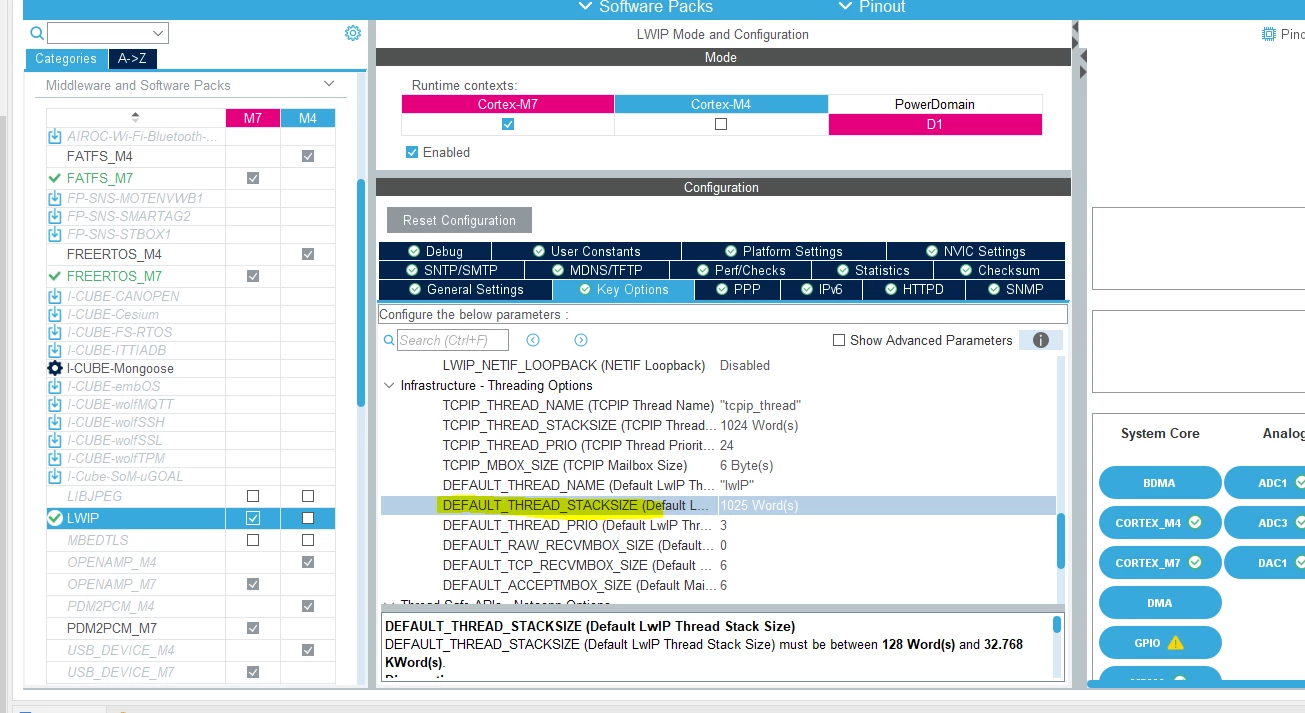

Where does LwIP DEFAULT_THREAD_STACKSIZE apply ?
Hello, I'm using lwIP and I try to change DEFAULT_THREAD_STACKSIZE
But where it applies ?

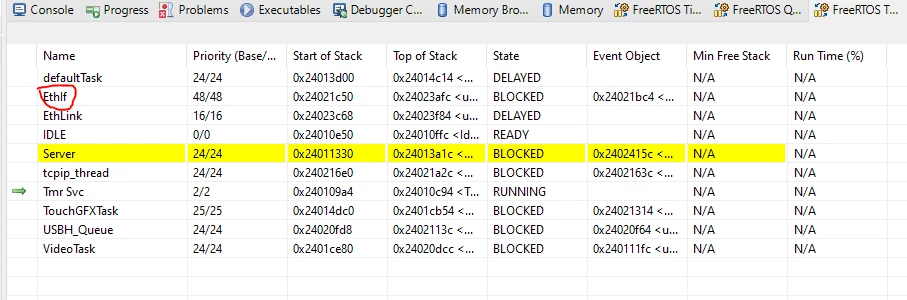

I have my code under version control but I don't see any change ... and I don't see "lwIP" thread, maybe EthIF ?
Andrew Neil
Andrew NeilBest answer
May 13, 2025 9:58 AM UTC
https://www.nongnu.org/lwip/2_1_x/group__lwip__opts__thread.html#ga7f93dfeaed4021061959f822def602cb
