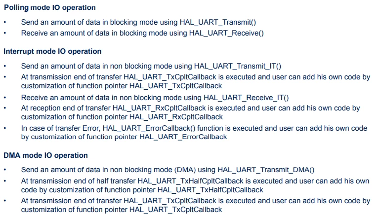

Where can I find some naming conventions for HAL related drivers?
Some HAL functions, like HAL_UART_Transmit_IT use "_IT" suffix. Is there a convention for it described anywhere? Let's say my driver also has some blocking mode and interrupt mode calls. Should I use "_IT" suffix? Or maybe "_async"? What does "_IT" even mean? Like "InterrupT"? ;)
Is such function called "asynchronous" in C? What about functions that exit immediately but call the callback when something they started is completed? Is there a special name for them, is there a special naming convention?
Should I place the callback as the last argument, or can it appear anywhere in the signature?
The term is general - not specific to C.
Also known as "non-blocking" - as opposed to "blocking", where the code waits ("blocks") until the process is complete.
That is asynchronous (non-blocking) operation.
Parameters in C functions are identified by position; if the call back is the last parameter in the declaration, then it must also be the last in the call.

Hi @Adam �?yskawa​ ,
For each STM32Cube firmware package, you should find a user manual explaining the HAL & LL drivers of each STM32 product. If we take as example STM32F4, you will find UM1725 Description of STM32F4 HAL and low-layer drivers.
So here an extract from this document explaining the 3 operating modes for UART:

May 25, 2022 2:19 PM UTC
Thanks for directing me to the right docs, I took the harder path of digging in the HAL source code ;) This document clarifies it well enough.
