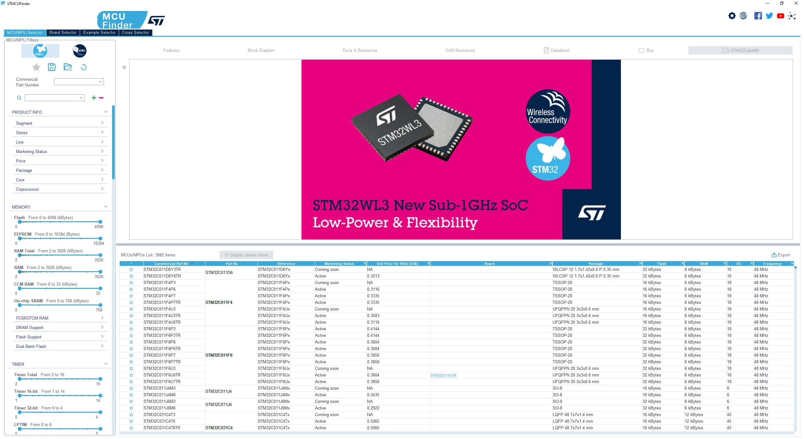

You can use the ST-MCU-FINDER which is an easy-to-use selection tools, self-maintaining documentation, and connections to MCU communities.
Also, you can use the STM32CubeMX which will do the same job.

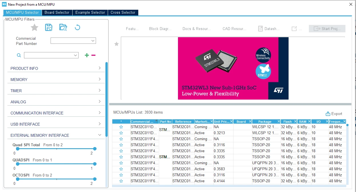

Thank you for your reply @STTwo-32 . I was hoping that the ST website could do it. I use Linux, and unfortunately many of the ST tools are problematic...
The MX tool embedded in Cube often crashes my project - I just use it for the bare-minimum of settings.
I have tried the standalone MX, but many of the sliders in the selector panels don't work! And I can't expand the fields in the panels either!
I have just installed ST-MCU-FINDER, it's better than MX, but it doesn't work correctly - I set the minimum UARTS to 4, it list the STM32L151 as an options, but it only has 3 UARTS! It doesn't see that Cube is installed, and I can't expand the part number field enough to get the full part number to transfer manually.
Even doing it manually with the datasheets is problematic - The STM32L432 states it has 4 UARTS, but MX only lists 3, and 2 UARTS share the same pins!!!
Sorry to be a pain, but I don't understand why this is so difficult.

Update: After running MX or FINDER, my CubeIDE is broken! The main screen opens, but I cannot open project files - it states that there is "No Consoles" available for the files.
I had to download and reinstall CubeIDE, and import the projects into it...
